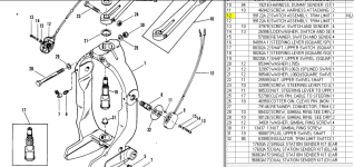

So im converting this old gimbal to the square/spline upper swivel shaft and i need the 2 bolts that pinch the square on the shaft at the top of the ring. The used gimbal ring did not come with hardware.
This is an aluminum V hull running fresh water only that lives on the trailer in my yard.

They are just standard S/S screws, nothing special. You could also order them from Merc... (parts list below #28, #29x2, #30)

The gimbal ring clamp screws are only torqued to 75 newton metres. Your bolts will be plenty strong enough for that...
(And this is why are prefer using OEM. No messing around with will it do the same job)
