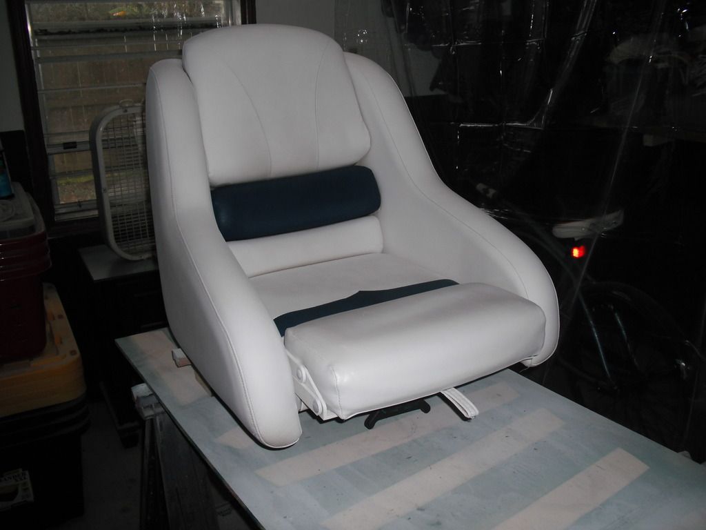

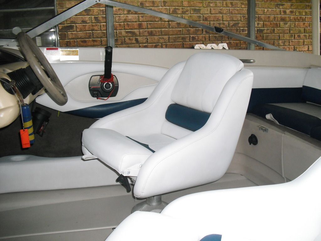

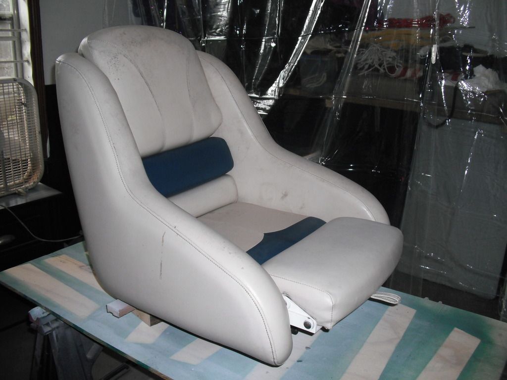

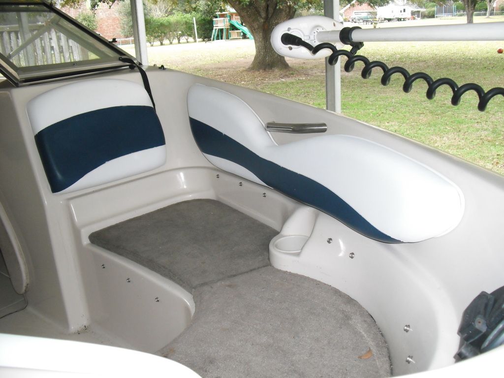

More progress. Got the Captain's chair done today. Some cool weather coming in so the 2 cushions, 6 side panels and misc pieces will have to wait a bit.
They look better in person. The lighting in the garage isn't the best for taking photos. Of course it could be poor photo taking talent on my part. LOL

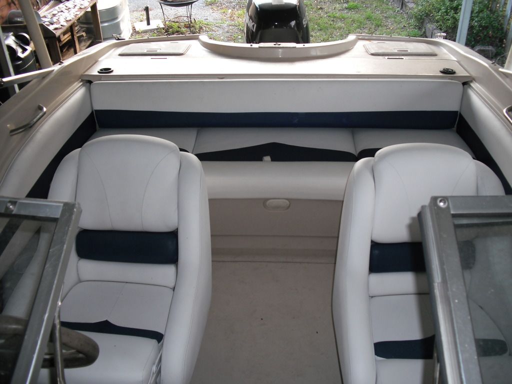

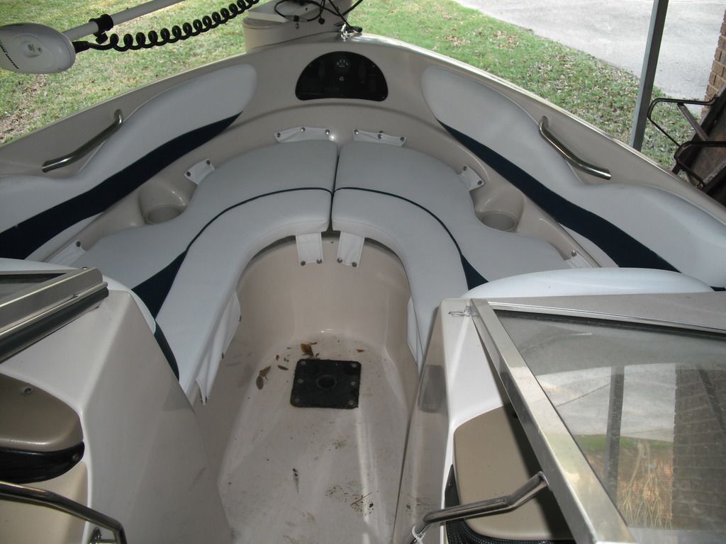

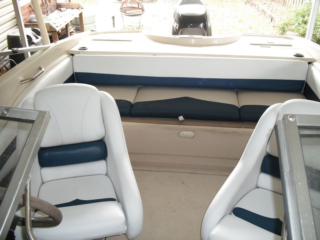

Made pretty good progress the last 3 days. Still have the 3 stern cushions, 2 bow cushions and sunpad to do. Have used 6 cans of paint so far and just ordered 3 more cans. I figure it will take only 2 more cans to finish, but will have one spare can for any touchups in the future.
Bayou Dave
Dec 13, 2012
1,780

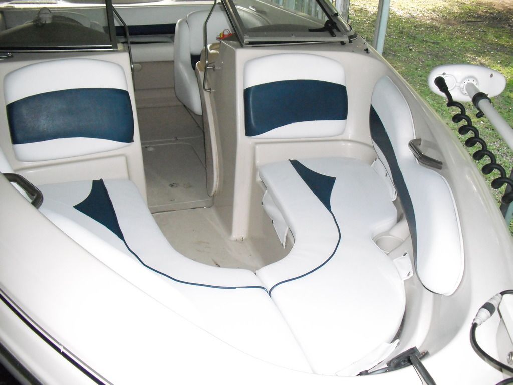

Finally got it all done. Glad I went with the bright white. Total expense was $200.31. Sure beats the heck out of new vinyl! If it lasts for 2-4 years I will be happy.

26 pieces to do is a lot. Are you doing the seats also? Are you using SEM or some other product? I chose SEM because of the UV protection it claims to have.
