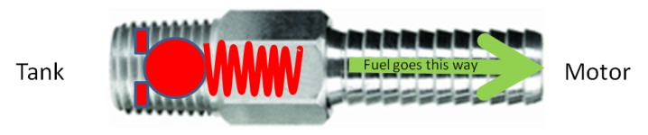

Might want to take a look at the anti-siphon valve on the gas tank. On older boats they can get corrded internally and then the ball sticks and restricts fuel flow.
