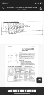

Our local boat dealer pulled the codes, not sure with which tool. I attached the details.
I believe you put in another post that if you have analog meters, the SPN 697/698/699 could be ignored. We have analog meters, but the speedometer has a small LCD reading. Every meter reports normal range function.

They’re low voltage to gauge codes- oil pressure gauge, temperature gauge, trim gauge. I failed to attach the image. Again, our boat is all analog gauges, not digital.

The page you posted in the screen shot isn't for your engine. STOP using this diagnostic manual and get a copy of EGC diagnostics part number 7749393. This is why a serial number can be soo important.
Yes, on this engine with can bus (digital) gauges you can disregard SPN 697-698-699 FMI-5 faults.

The page I attached in one of my earlier posts is the code report from the original mechanic’s computer, but they added the troubleshooting step pages to it.
When they connected the computer to our engine, we were standing there and saw those exact codes, it was just a screenshot they took to include with it.
What is most troubling is the original mechanic and boat dealer chased the 697/698/699 codes to conclude it needed a new ECM, when in reality those codes don’t even apply to our engine.
