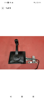

Can someone possibly advise. I changed the throttle command on my 2001 wellcraft martinique 2600 5.7GS. The old throttle lever was stuck and in poor conditions. I managed to get a hold of a newer Volvo Penta throttle without kill switch as i it had it already just not on the command. The old cables do not look like a match. At least to me. So i would like to update them since i will have it apart. The current cable number for carb is 32377-003-192 0, and for the outdrive is CC23017. I have attached a pic of the updated throttle if anyone can advise on the cable substitutions if you know.

Are you wanting to color match the 2 cables as it looks like 1 may be red while the other is possibly black?
They are both 33 style cables which is normally the type used for Volvo.
Does the shifter connection points look the same between the new and old?

The color is not a concern for me. The cc23017 has a black barrel looking thing at the commander side. So i figuered i would ask since that one needs changing for sure. Its fun and pleasant where its located. Might as well knock it out before i have to go back there again.
