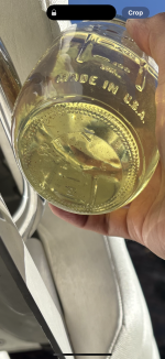

Fuel filter drained. Some sediment in bottom

and gas looks fine

There ya go, a connector not even connected.
My guess is there is another one somewhere
and gas looks fine
