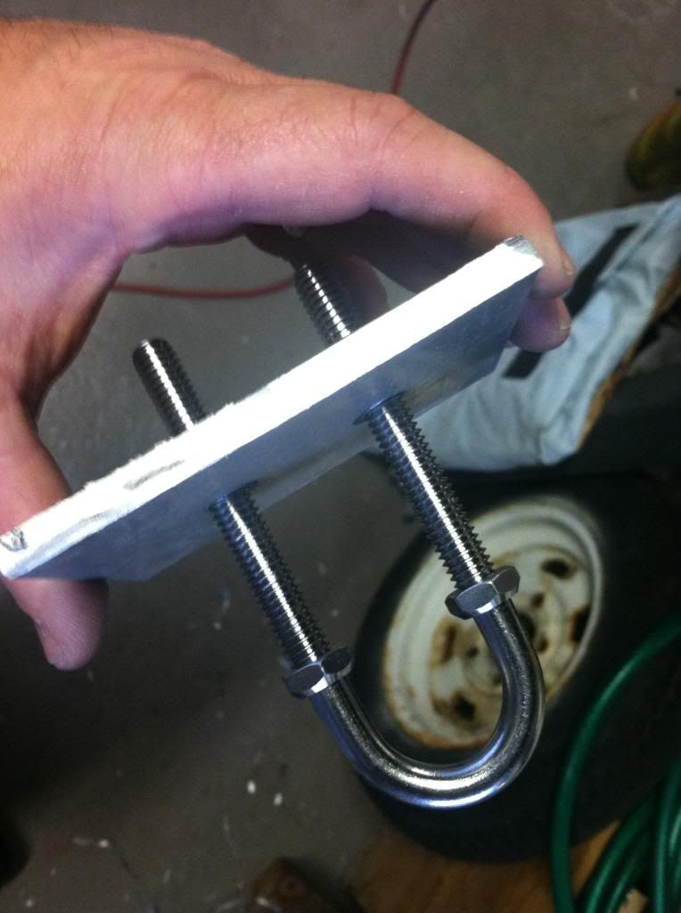

If you are wanting something like what you have in the link you could use a backer like I put on my Starcraft when I redid the transom. I used some aluminum backing plates like these.
Here they are installed.

That aluminum piece is about 1/4 of an inch thick. I got it as one long (8 foot) piece and cut off (4) 4 inch square pieces. Two for the towing eyes and two for the motor bolts.

A 1/4" aluminum backing plate will be fine. HOWEVER, the stern eye and backing plate must be installed on the wooden part of the transom. Don't try to mount it where all you have is just an aluminum transom.
