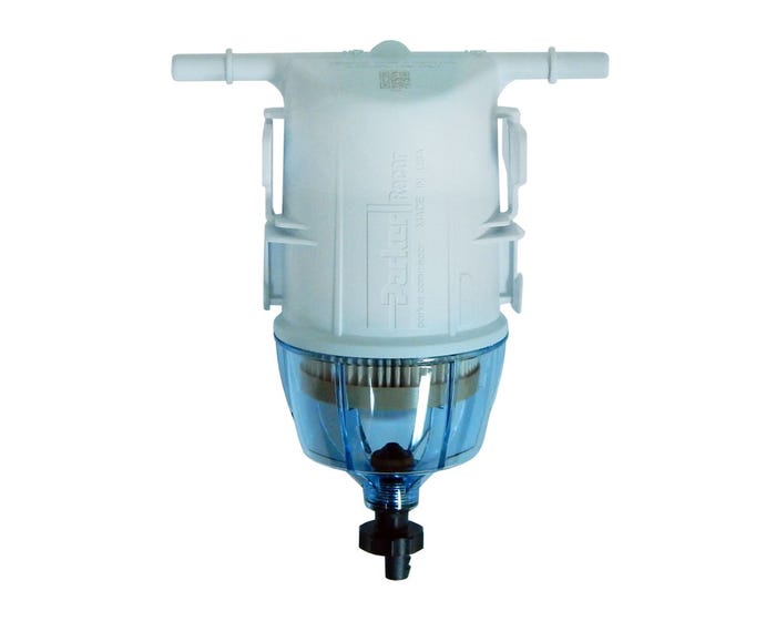

I have a Sea Ark 1860MV Jon boat with a 60 hp Yamaha 4 stroke outboard on it and the other day I was out on the river (Missouri) and had problems with it staying running and come to find out I had water in the fuel. I surmise it came from condensation over the winter in the fuel tank and was told by the dealer that I should put a fuel/water separator ton it to take care of the problem. I ordered a Fuel Filter/water separator S3227 and got it yesterday but my question is this the right size for my application? I thought it would be smaller in size as I was intending on mounting it on the transom and although there is room it just seemed like overkill. If not so be it just wondering for my own peace of mind. Thanks for your ear.

When push comes to shove you can never have too much capacity (water) in a fuel filter
Having said that, here is the small boat version.

Thanks for the input, after I looked at the Racor r23299-10 I decided that was what I was looking for so ordered one. In the 50+ years I've been on the river I've only had one other time when I have had fuel problems and both times I was up river instead of down and I don't intend to have it happen again. I appreciate the fast response to my question, thanks again.
