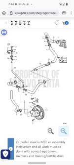

So there are several parts in the raw water intake. Not a straight run from outdrive to raw water pump

I would check the and tighten the hose clamp labelled as part no 5 in the drawing posted by Donald0039 in post #4.
I just got a Milwaukee inspection camera.
I will be looking to check and follow the entire path from the outdrive to the raw water pump. Including #5. I have also been replacing the SS spiral clamps with SS constant torque clamps.
