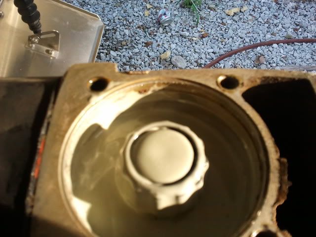

I was at the lake with a buddy yesterday doing some tubing and skiing. As I was getting in the back of the boat I noticed a milky substance on the top of the drive. Looks like it was coming from the dipstick. I had a screwdriver with me so I checked it and it was tight. I changed the oil in the unit when i got the boat (middle of June) and rechecked it after the first trip out and everything looked good. Pulled the dipstick out today and the o-ring was missing. The oil is almost a toothpaste consistancy and will barely drain out. I'm thinking of putting fresh oil in it and running it in the driveway, drain refill and watertest. There was also some metal on the drain plug.

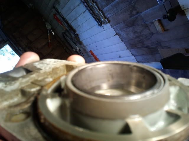

top cover off, alot of sideplay in the shaft, I'm assuming tis is normal since the race is in the cover.
Race is a little pitted

Pull the outdrive and check for water in the bellows. Then drain the drive completely and pressure test it. Since you have a dipstick, it must be an early model Gen II outdrive, you didn't mention year or model.
The early Gen II shift shaft bushing in the lower unit, and the plastic seal carrier under the water pump were also known sources of leaks and the carriers were both redesigned in later years.
It also sounds like you may have been checking the gear lube without replacing the gasket on the dipstick (maybe on the fill and vent fitings too). That is a no-no, never reuse the gaskets.
