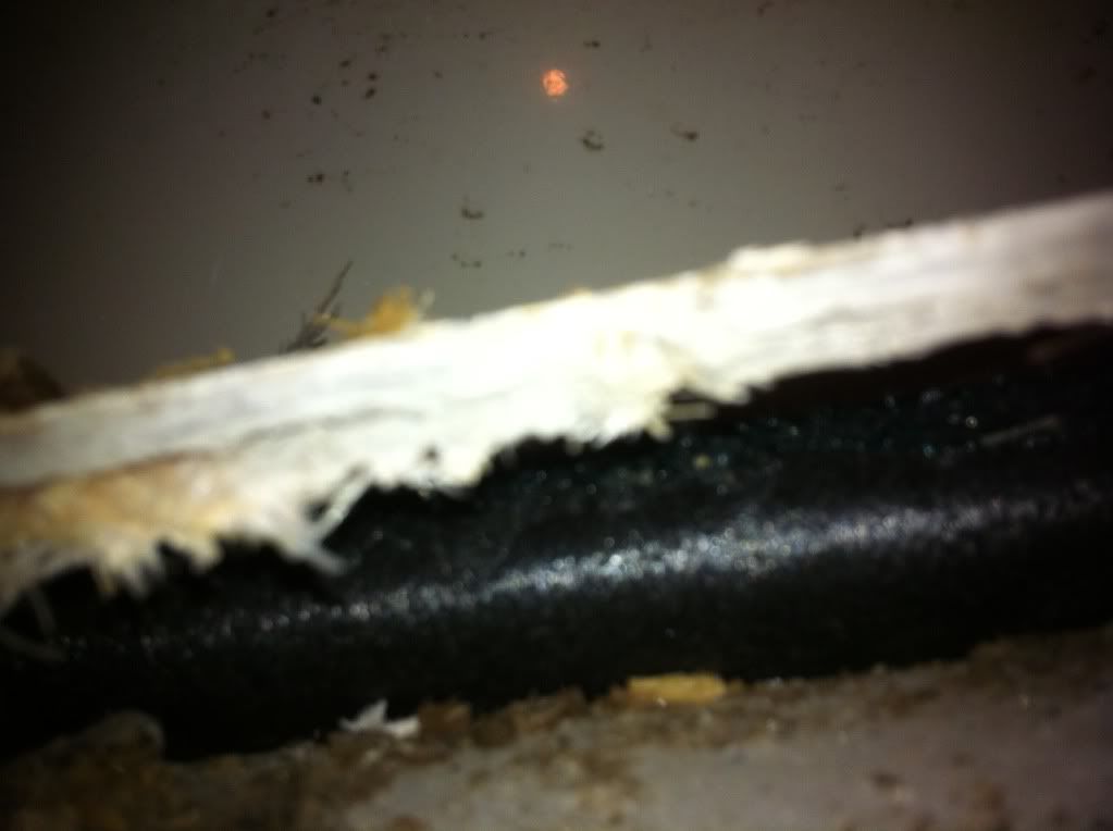

Got the plate out - it is about 18"x12" or so. Maybe 1/8" thick.
Once I got the bottom layer of fiberglass up, I ran into a panel or "something".
I'll get a pic tomorrow - didn't have my phone on me and had to run to work tonight.
Any ideas what the heck this is? (I know pics will help, but maybe someone has seen this before?)
I also found good wood about 2-3" from the ski locker. With the panel in there, I'm not sure if I'll have room for flanges - but I'll figure something out.
Tomorrow I'll head to the back seat and see how far the rot/wet wood goes. I'm betting it goes all the way, but will just have to see. I really hope not.
Pics tomorrow - I promise! :)

perfect size for a pedistal seat backing plate

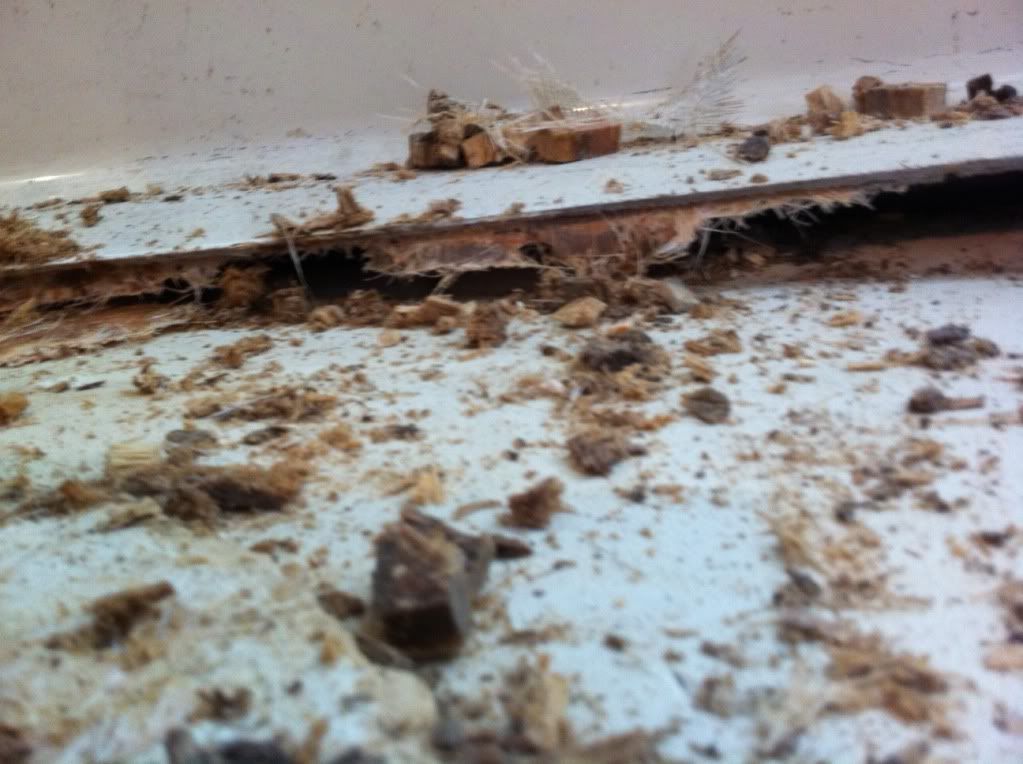

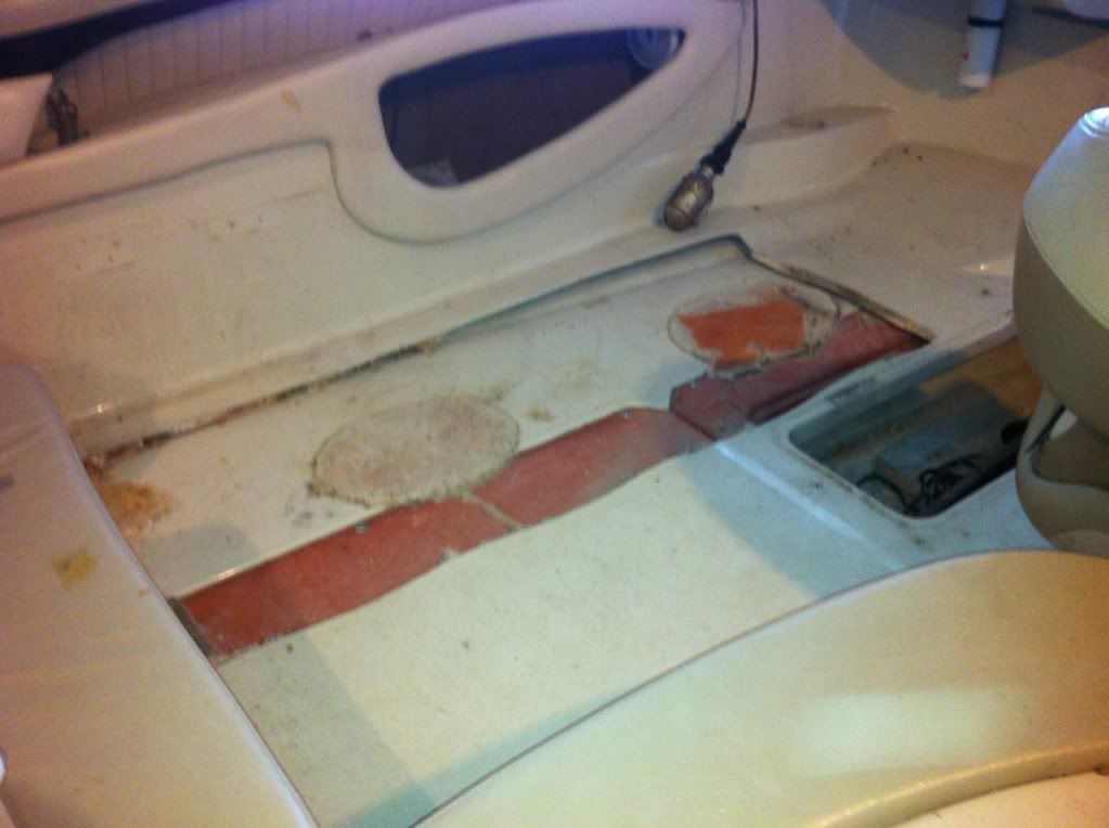

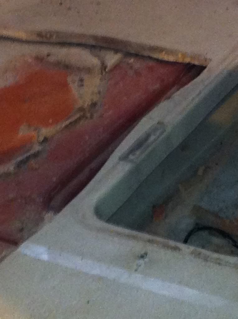

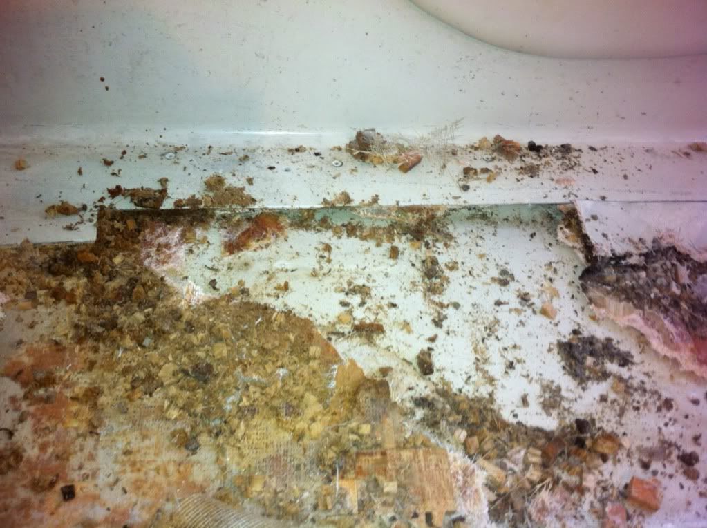

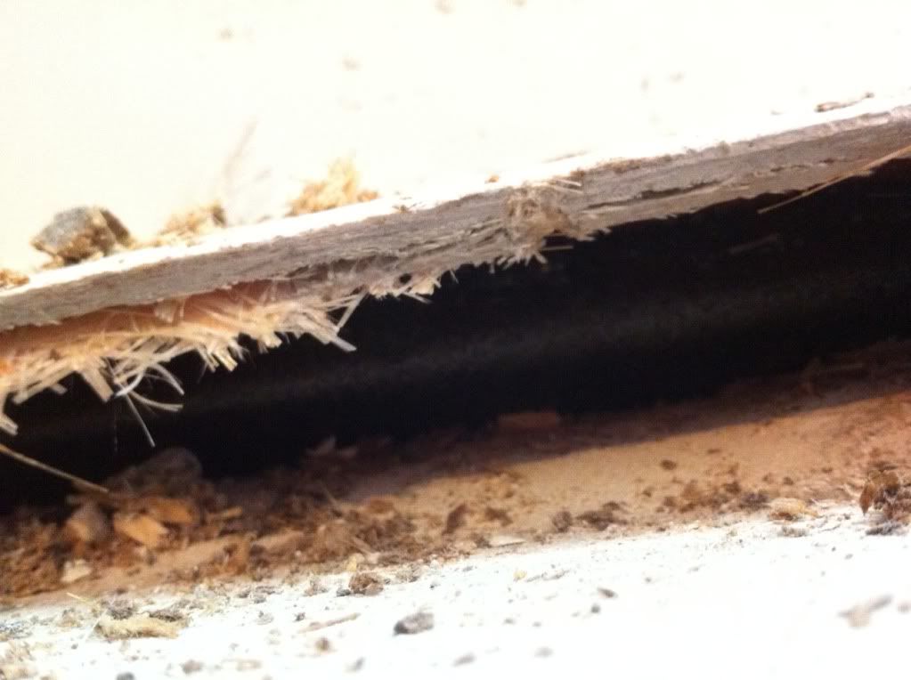

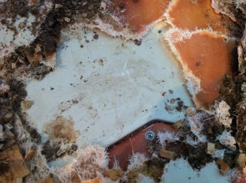

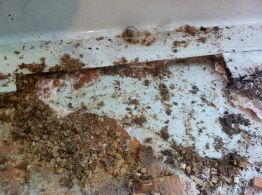

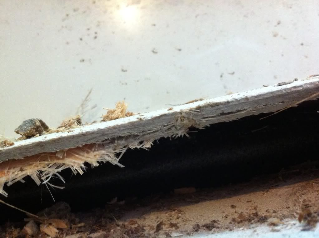

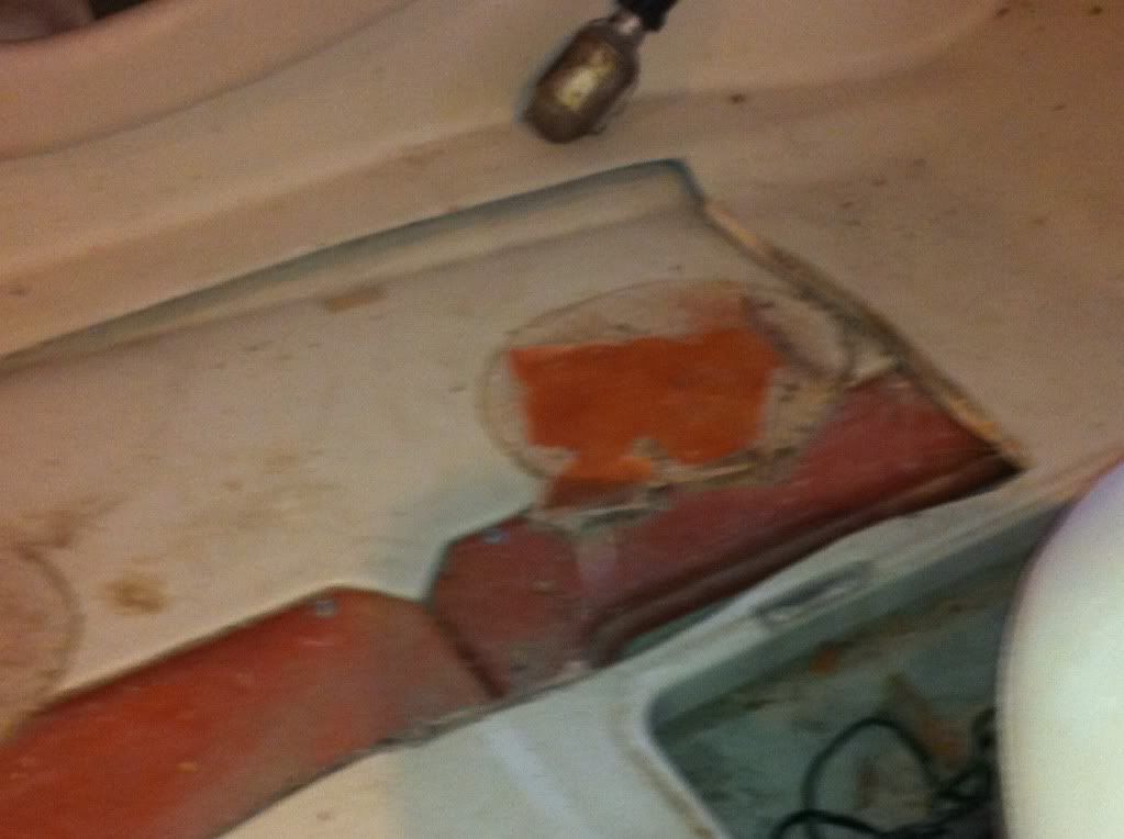

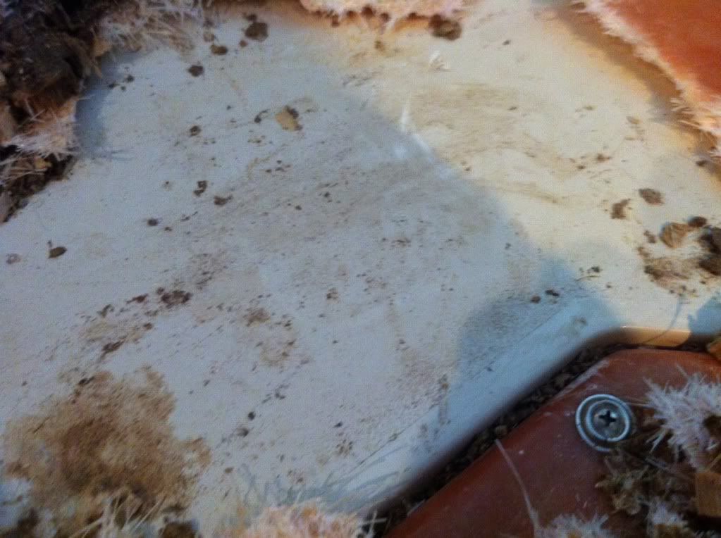

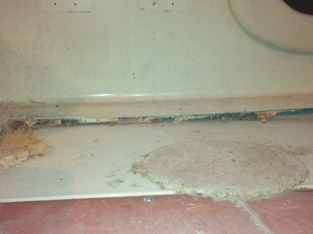

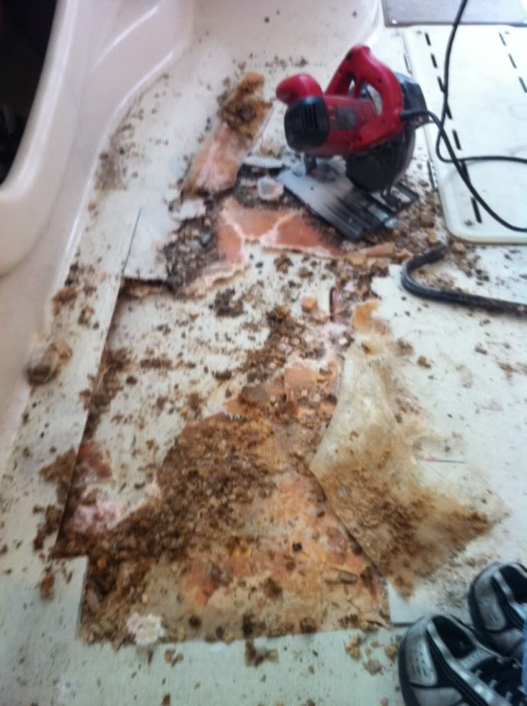

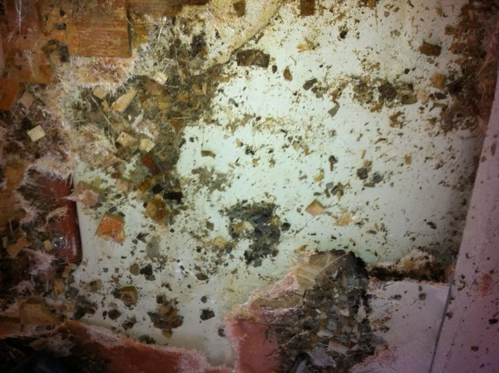

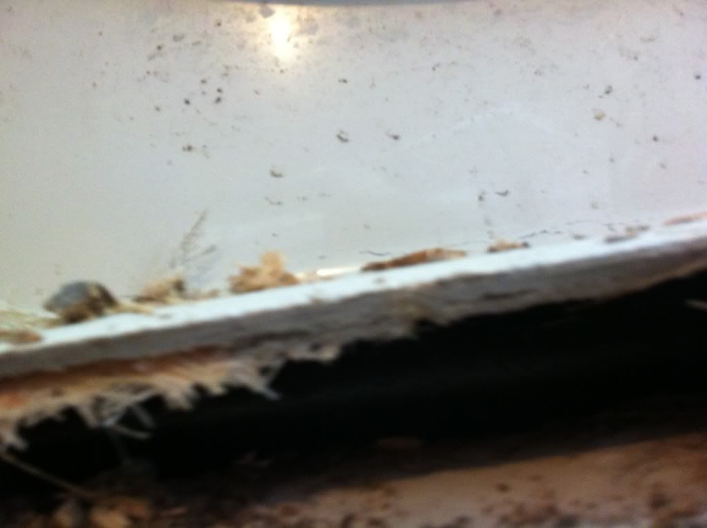

Ok - so I think I may be lucky. It looks like I'm going to end up replacing a piece of wood from about 6" in front of the pedestal seat all the way back to the bench seats. I say lucky because I guess glastron builds these with the deck above another deck? (just guessing anyways)
From the looks of it, the deck is actually attached to the sides. I have pulled the old wood from part of it, and they have foam in behind where it was:
So I'm thinking I can lay the patch up under there, screw it down to the second "deck"? Then I'd lay glass over the side onto the new deck and sand it out to look factory again. Am I wrong?
Anyways, here are the pics - a little late, but I had to work almost 20 hours yesterday, so I didn't get a chance to get them.

Okay - so I have the hole roughed out. Need to go back and square up the cuts (my circ saw did not do a good job of cutting straight at all).
Still need to dig out some wood from the edges, but I should be able to knock that out fairly easily.
Questions: Why would they raise the deck? There are two spots where the pedestal seat mounted that they have poured some kind of epoxy, and again at the back for the side bench. Other than that, the entire deck is pretty much "floating" (I assume it is the same on the other side as well).
I'm considering going with 3/4" Marine Grade Plywood for the replacement. This will likely be a bit heavier than the standard wood, but I'm unsure if I can get 1/2" (do they make it? I haven't looked yet). The bonus to being heavier on that side will act like a ballast somewhat. I'm 280lbs, so with my wife (130lbs) and son (40lbs), it may even it out a bit. Is this just a dumb idea? Even with 1/2", it will be heavier than the wood they originally used, but not as heavy as 3/4".
Could I put the floor on top of whatever is under the floor and then build up from there? Any negatives to this?
