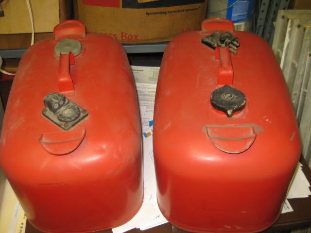

Cleaning out my grandfathers garage, and I found these two gas tanks up in the attic...
I looked inside, and they were spotless, So I was going to use them as spares... I took a quick glance and I thought they were Evinrude/Johnson fittings, so grabbed em and brought em home...

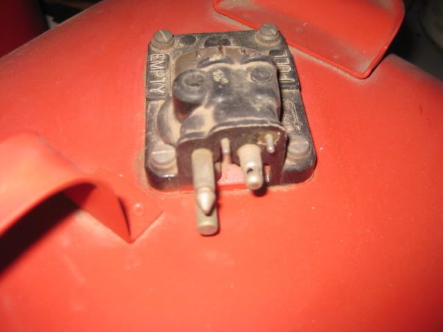

But today when I want to test them out, I noticed I couldnt hook up my hose... They have an extra "prong" sticking out, as well as two little pins near the top (see 2nd picture)... so my fitting wont work... they look like OMC but now I dont know...
The fittings are built into the plate in the top, so I cant change them out... now just wanna know what they may be for??? He did used to have a 1955 35horse Johnson, they might have gone to it..???

Close up of Fitting:

Those are old evin\johnson tanks...not sure why they have large fitting on them. The two pins are to move check valves... one lets air in the lets fuel out.
A standard evin\johnson fitting should work.

standard OMC fuel tanks. that came with the engines, if not rusty in side, still usable.

Neither are pressure tanks, they are the old style single line tanks, I have 2 of them, I like em!

Pushing one of the pins in vents the tank. No need for a vented cap. The other pin is a fuel shut-off valve. Keeps gas from spewing out when the hose is unplugged.
If it leaks gas around the pin when the hose is connected, there is an o-ring in the housing (around the pin) that needs to be replaced. It will also suck air if that o-ring is bad.

standard omc tanks.if you plug in your omc line it will use the 2 top ones.bottom one is of no real matter .those tanks sell up here for 5-10 bucks.

The one tank with the round fuel guage window is the older of the 2. That older style fuel guage was used from the start of the single line style in 1958 (J/E) through about 1964. I don't know, but Gale may have used it back to about 1956 approximately.

Since no one else mentioed it - the capacity is 6 gallons.
