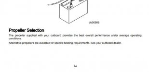

I just want to know where in manual/s and which MFG's states after break-in to re prop..
Here is from Merc/Tohatsu manual..

Faztbullet
Mar 2, 2008
15,938
All I am asking is when you make a statement where did you get this information? No manufactures manual that I own or have digitally say to re-prop after break-in. That like me stating that all manufactures recommend the use of Walmart oil. If you state something have data to back it up.
