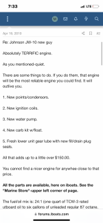

I saw this post.
With being a newbie to engines is this going to be that difficult? I just don’t want mess anything up beyond repair.
I’ve done all but condensers and water pump. What exactly are the condensers. Nor the gear lube and new seals.

The water pump is actually quite simple and easy, there are U tube videos on that, the screw on the lower unit can be reused, it is the gasket washer under the screw that keeps water out. Last ones I bought were 3 for less than 5 bucks. Once you drop the leg and look inside the pump, you might just need the rubber impellor as long as the inside of the housing is not scored or grooved. That rubber impellor can get dry with age and the legs break off and overheat the engine. Do everything right and your motor will be worth 3 times what you paid for it.
Yes I just found this video on YouTube
That raised my confidence in being able to do this repair. I also bought a condenser, drain plug screw and washers.
It came with two washers. Do I use them both? I’d assume so or atleast I’ll notice when I take it apart tomorrow, just figured I’d ask before I delve into it.
