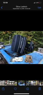

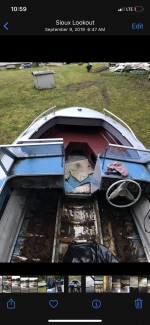

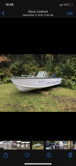

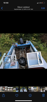

Ha I was just researching my boat looks like we have the same boat! When I bought mine it was a total rebuild! Required a fair amount of patches to be installed on the hull unfortunately! Here’s some pics!

That's awesome! Thanks for posting up those pics. You've got the modern Yamaha power as well. I'm hoping to splash this one in the next couple weeks. Need to update with some more pics at some point.

Looks like you went all out! I’ve kept mine pretty low on weight! Didn’t even bother with foam under the floors. Yes I just repowered this spring with a 70 yam. Break in is done and she’s getting 38 miles wot with little weight in the boat! With another person it drops substantially to 34 miles wot. Cruises nice around 27! I’ll say the one thing I don’t care for in this boat is with such a bull nose to it if you hit any kind of serious wave it bites in! The more weight you can keep in the back the better that gets!
