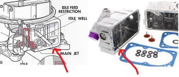

the part changer at the dealer (can not call them a mechanic) did not clean out the accelerator pump passage. on a holley, that is on the bottom of the fuel bowl and first to plug.
you are describing a failed accelerator pump circuit. again, your carb is fine, just needs $10 worth of cleaner and gasket. this is something you could even do.
you are not getting fuel thru the squirter.
stop going to that mechanic.
get a bowl gasket and a metering block gasket. if you do not know what you need. go here https://forums.iboats.com/threads/searchable-holley-carb-list.771381/
and download the spreadsheet I put together. look for the list number you have and get the appropriate bowl and metering block gasket.
if the ones you have are blue, they are reusable
disconnect the fuel line
pull the 4 bolts on the face of the bowl, these are #12 screws and you will have either a hex or a slotted screw head
use the handle of the screw driver and tap the bowl on the side to crack teh gasket loose. to not pry
same goes for the metering plate
now at the bottom of the bowl where it meets the metering plate is a small passage. that is plugged and needs to be mechanically and chemically cleared
the ONLY way to clean that is with solvent and manual probing. they need to run a fine piece of copper wire or fishing line thru it to ensure it is clear.
and no, you can not simply spray carb cleaner from a can and hope it works.

here is a side view of the carb. the newer ones have hex screws, the earlier ones have slotted scrws.
the whole kit is holley part number 703-036, however you only need the two blue gaskets.
you can buy a two pack from Summit and with shipping, etc. have it to you in the UK by Friday.

FYI, you should not need to pull the carb or strip it, only remove the bowl and metering plate to clear the accelerator pump circuit.
this will help you. https://www.carburetor-parts.com/assets/manuals/holley-2300-4160-manual.pdf
clean out this passage. you will need to carefully remove the accelerator pump cover and diaphragm. you will have either the rubber mushroom check or a real check ball check for the primary check
the secondary check is in the discharge nozzle, make sure that is removed and cleaned too. with the throttle blades closed, choke blades held open, use a #3 Phillips screw driver, and remove the screw holding the discharge nozzle, there is a round crush washer under the nozzle, and in the nozzle is a weighted ball check or a fuel needle used as a check. simply make sure the check moves freely.
