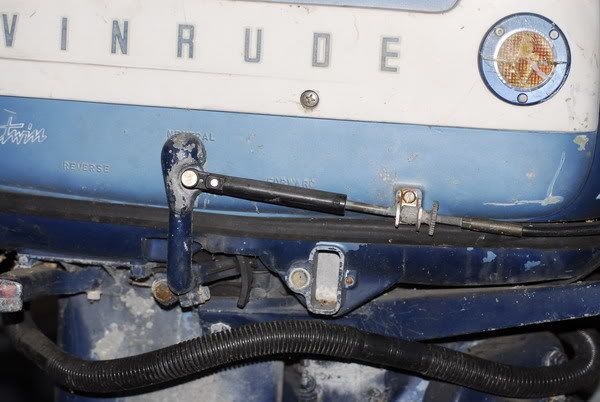

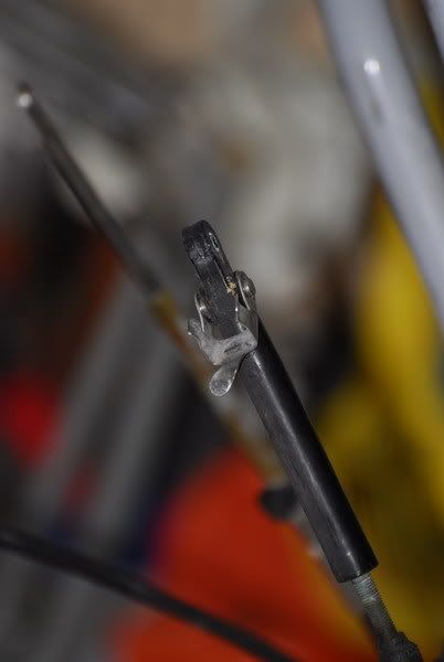

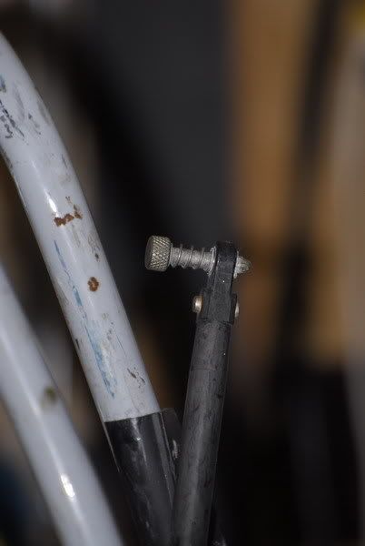

The following photos show the pieces that your are missing on your control cables. First, you need the stainless steel gate that holds the throttle cable on the motor's throttle arm/pin seembly. Second, you need the spring load pin that fits into the gearshift handle on your motor.
Once purchased and installed on your cables, this is how the cables should look when attached to your motor.

Re: Which control cables? '77 35hp johnson
Something that I forgot to mention - it doesn't matter if your control unit and cables are the pre 79 version or the post 79 version. All that matters is that you have the correct cables for the control unit, and the correct parts for the cable ends. Go get the gear shift pin and the throttle bracket gate and you will be fine.
On the shift pin, there is a small pin going through the end of it - you will have to remove that to insert it into the cable end. Once the larger pin is in place, you put the smaller pin back in place. You'll see what I am talking about when you buy the part.

thanks jay!!! i actually found that little slide clip at a johnson dealer locally so ibought it yesterday and it works great...I had to order the pin/spring/ combo one, should be here on thursday. I appreciate your time and willingness to help...thanks for the pics man!!!:)

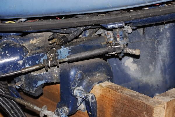

is this rod supposed to be bent? it's the rod that fits into the end of the steering teleflex cable
That angle looks about right - just hook the steering up and runa it back and forth a few times to see if everything is working as it should.
yes. it bent that way for clearance.
yeah jay i did that, but it didn't seem to wanna turn as far one way as the other...That's what got me thinking it wasn't supposed to be bent:confused:...I guess im good, thanks guys!
yes to allow clearance when turning.
Is there a large difference in turning angle from one side v. the other?
not a large difference...but i'd say atleast an inch or two less movement...I won't be able to cut donuts in my boat:redface:
If the difference is only an inch or so, I would say the condition is normal.
