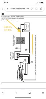

This is the Lewmar schematic, except it does not show how to wire through a switch (battery isolator)
tpenfield
Jul 18, 2011
19,264
No solenoid shown. Toggle switch looks like DPDT momentary switch
Not a proper wiring diagram IMO

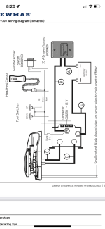

I uploaded the wrong picture.
tpenfield
Jul 18, 2011
19,264
That updated diagram looks good. The positive lead goes from the breaker to the solenoid (not the switch)
FourWinnsLC
May 28, 2012
59
Yes that all makes since, but what I have been researching it needs to go from solenoid to breaker like you said, but I want the windless to be a switched device, so when you turn the battery switch to off it kills the power to the windless. That’s where the question I have comes in. Currently I have it wired to the #2 post on the battery switch. But in doing that the windless always has power. After some research I believe I need to use the common lug on the battery switch not the #2.

Do you have a master battery switch for the boat (like a Pero Switch)? It would be the common lug as you mentioned.
Since the current to the windlass is so high (30+ amps) you cannot really run it through any instrumentation/helm type of switch. That is what the solenoid switch is for . . . similar to a starter motor solenoid.
What is missing from the wiring diagram is the battery switch itself. Most boats have such a thing.
