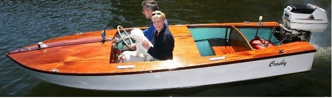

I have purchased the plans for a Glen-L Zip and hope to be building it for my Grandson's once I retire. I also want to attempt to take an Old 18' Glass runabout, remove the top cap and replace it with a wood one. Kinda like the first boat I ever owned a 57' Crosby!

Very nice! Brightwork decks on a runabout always adds a nice touch to them. The Glen-L Zip would be a nice one t build.
