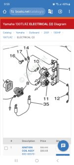

Diagram

So this motor uses an up relay and a down relay. Seeing as it won't go up or down just a click from each relay does that point to the relays being ok?
no, you need to measure voltage to the motor.
make sure the positive and negative is getting to the motor.
you can also make sure you have good voltage getting to the relay, not just the control voltage causing the relays to energize
