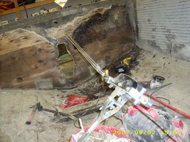

my transom de lamed from the glass hull i could all most pry the whole trans off in one peice but it was just a little too tough......

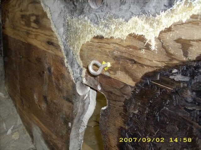

so i put a hook thru the transom/ wood only

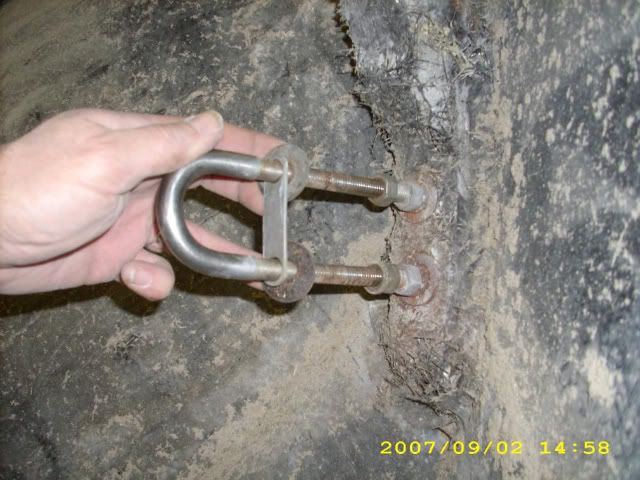

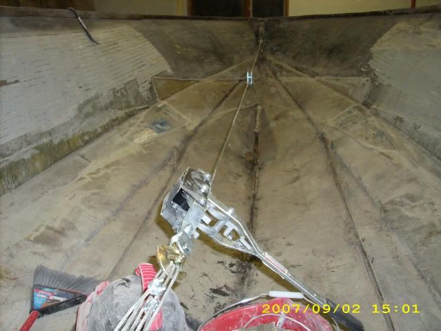

then attatched a transom u hook to the bow end by lightly bolting it to the existing interor bow hook
then attached a comealong to the two
cont......next post
