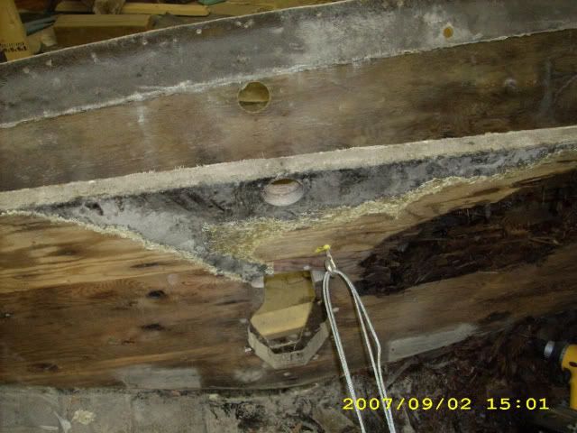

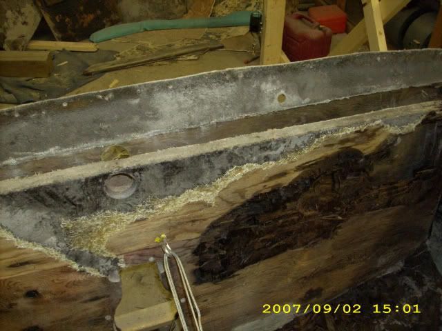

my transom de lamed from the glass hull i could all most pry the whole trans off in one peice but it was just a little too tough......
so i put a hook thru the transom/ wood only
then attatched a transom u hook to the bow end by lightly bolting it to the existing interor bow hook
then attached a comealong to the two
cont......next post:D

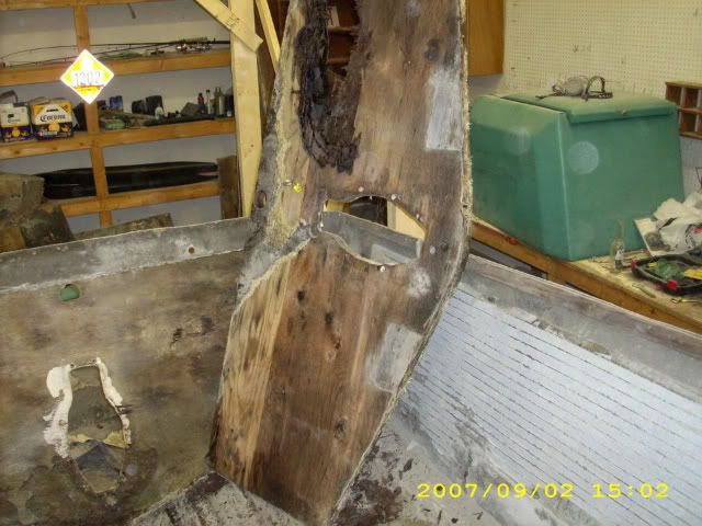

then i started to crank (watching bow stress and transom glass stress of course!)
and out it popped !!:D
man did i get lucky !!!!!! dodged a bullit there.....
all i gotta do is grind off the lam till i see hull and that part of the job is done!

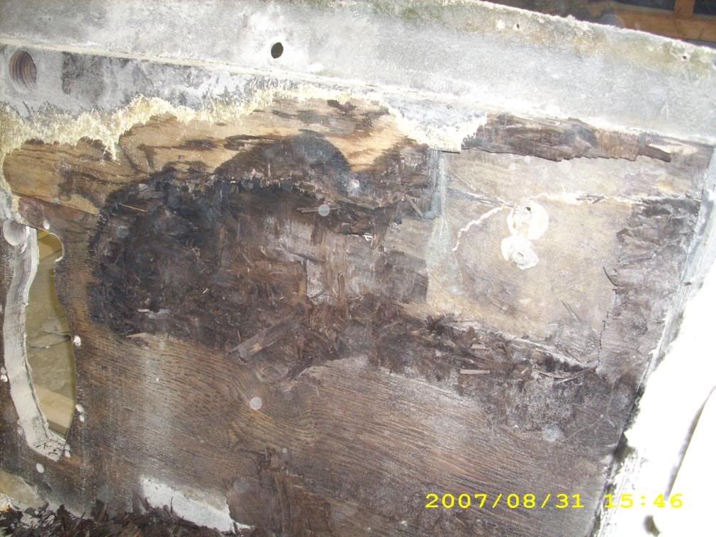

just to the right of the eye hook is a two foot hole rotted right thru 2 lamed sheets of 3/4. ill find a pic !

picks of the rot are tough to see...but here goes
all the rot is on the right side a foot from the top.
the whole right side was toast....or should i say mush!!!!:D
and wet !!! that thing must weighed a hundred pounds....(or 45 kilos)

I'll say you were lucky, not only did it come right off, but in one piece so it'll make a good template. I had a similar experience with the deck in my 88 Four Winns, cut up to 3" from the hull, and since the deck was only stapled down, a little prying with a prybar and it just popped up, used the old pieces for a template which made fitting the new ones go faster.

Now the challenge to you is reinstalling a new transom and laminating it to the hull and the stringers without the skin there. Thats a lot of planning and glassing becides the wood of the transom. Now you got to tab everything together without a piece of the puzzle.
Use the old wood as a pattern. You'll even get the outdrive hole in the right place. ;) Works great. That's why it works so well to remove the inner skin.
yup you bet dj.....
the one side is so rot that it isnt there...gone.. but i can still use it and just flip the wood..perfect copy.....in a little worried cus its so wet that it will shrink some. but ill just measure the template and compaire it to the hull.
my mech says he wants to cut the out drive hole...he promises me hes gonna glass in the wood, but i wanna be there to see it done.. dont wanna do all that work just to have some one do it thier way and not the i boats way!
