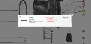

Ok so I plan to replace the impeller now. But as I'm watching some videos I noticed something. In the videos they mention this shifting guide and say dont loose it or don't change the position. Well I don't have one at all it seems. First pic is a screen cap from youtube. The only item I have on the shifter shaft is the one circled in blue and presumably anything underneath. All the highlighted parts above it are missing.

Checking around more, I see that the third image says "note, not needed for PT model." This applies to both the major parts I was missing. So I might be good, after all. Just need that impeller still

Non PTT models have a locking rod that locks the engine down in all but forward.
The shift guide in in the gearcase, just in front of the waterpump/driveshaft. It is a plastic casting, which you circled in red. Pull it out of the gearcase, and install it in the midsection, and it will hold the upper shift rod, in the correct position for reassembly.

Finally, the part I circled in red is missing in my engine altogether. That image is from a youtube video. If you look at the final image in my previous post the crowley parts diagram says that it is not used in the PT models.
