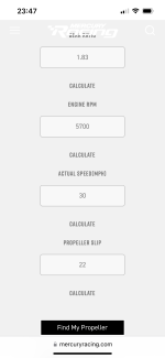

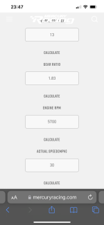

So just had a wee play with your numbers suggested above, with the 30 mph…5700rpm. Came out at 22% slip for me…assuming it’s the 1.83 gear ratio and 13” prop. Defo worth another run out to double check the data.

Ok. So you definitely need to go out and have another run. Zero prop slip is an impossible result. Not having a go by any means. Just trying to help. But yeah, certainly need another few tests. It’s just not possible to get that slip figure.
Keen to help out if I can. Do you know what gear ratio you have on your engine ? Think the model changed around that year or just after perhaps. One was 2 to one or close and the other might have been 1.8 something to one maybe. There may have been a Bigfoot or CT model with a lower ratio again too.

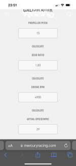

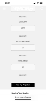

Here is what I got for the 15”. This and the above at 20% ish slip…might even be the norm for a pontoon perhaps. Either way…there is definitely a fair bit of variation or uncertainty around the numbers perhaps.

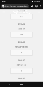

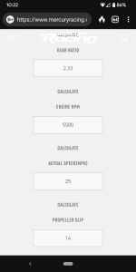

Guys I have a big foot. 2.33 gear ratio. Thought I put that in original post but I guess not.
I am in NH and unfortunately I don't think I will be able to get back out until spring. If you all think my numbers are wrong then you are saying that vessel view is giving me bad data. I haven't looked yet but anyone know where to call to question that?

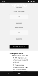

Sorry the 14 slip got cut off. Here it is. Run all your numbers with the correct gear ratio please.
