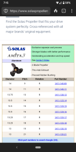

Lol yup this must be my first rodeo trimming an engine to get the most out of it 😂
I invite ANYONE on this forum to join me on my boat, prove me wrong, show me anything that is being done wrong or different from anything I have stated in this thread. We can even put some money on it, I could use some extra!
1" pitch changes listed below on the Solas site for my motor. The 13 and 14 are the last two I have been testing on that list. Gear ratio is most likely playing one of the biggest parts in this endeavor.

And once again, the MPH proves none of that to be the case, at least with the Solas props.
Vessel view will tell you one way or the other, exactly none of the last few things that @jimmbo mentioned to you. I tend to agree with him there. Got to be something else going on there. I’d just double check the prop size again. Make sure it’s for your gearbox size and fitting is correct. It’s absolutely got to be related to one of these things, or trim position/grip on the water.
I’d also add, that having had the vessel view mobile since the very early days, I’d you are referring to the max speed @RPM achieved screen afterwards…this isn’t always an accurate picture of what’s going on. It takes varied moments in time to record that data. So for example, if I run up to 6000 rpm at 45 mph in real time, then back off just as I achieve that top speed…the max speed recorded screen will have a little lag. So it will most times show the recorded data at 45 mph and @5700 or similar. Reason for this is that it’s taken a particular moment in time just as I’ve pulled off the throttle. So recorded the rpms lower as it’s dropped quickly, but the boat is still carrying momentum at 45mph, if you get me. Best to use real time data witnessed with your own eyes.

Wasn’t meaning that you were inadequate with the trim. Have a look at my last list there. See if that makes sense.

You were barely tapping your rev limiter on the original prop- that is basically about as good as it gets prop wise for a rig like yours. That is exactly how I prop my boat, just cause it can hit rev limiter doesn't mean you have to leave it pegged there.
One of the issues maybe overlooking with these results and the slip/rpm numbers that don't make sense is you are assuming the props published pitch is what it actually is, on relatively inexpensive aluminum props. Before you drive yourself nuts maybe worth finding a prop shop who can validate if the listed pitch is accurate.
