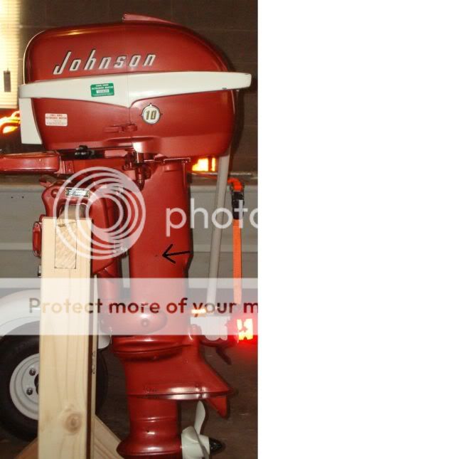

Also I noticed some oil oozing from this hole in the side. (see pic) Should oil be coming from there? I also noticed a little bit ozzing from behind the shifter. I know it shouldnt be coming from there. What causes that? Thanks.

That oil oozing out is unburned two cycle oil and that is very common to see that.

I wouldn't worry about the oil from the shifter area. Not uncommon for the bushing in there to have a little wear - I think there's a grease fitting somewhere in that track.
The oil on the side of the leg is also not uncommon. That "hole" is where the upper water tube grommet seats. As those rubber grommets age, they can shrink a bit, allowing blow-by as the exhaust passes by...
