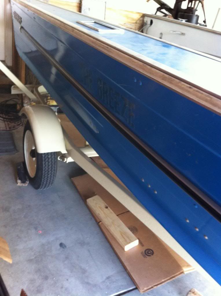

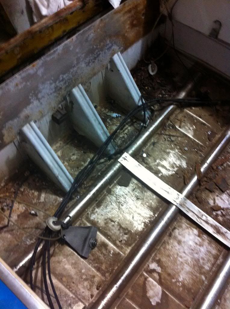

Shot another coat on the trailer, after a weekend of setbacks. Shot another coat on the cowl for the motor after stripping it for the FOURTH TIME!!!!!(I'm done with this part!!#%@%&^#$). Drilled reveets and removed screws.....floor and transom are out.

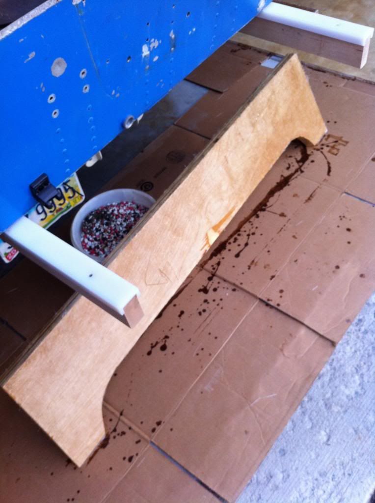

And she's back on the trailer.
New bearings, seals, wiring, lights, winch, and bunks. I used UHMW plastic channels for the bunk covers vs carpet. WOW! it slides with little effort on the plastic and freshly greased keel rollers.
Now to get the remainder of the debris and wash the inside of the hull....

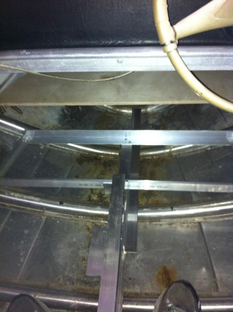

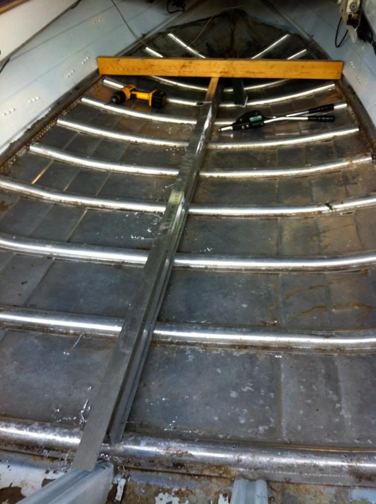

Pic of the substructure.. I used 1.5" 6061T6 aluminum "U" channel and angle. This is reeveted with 1/4" closed end aluminum reevets, steel mandrel.

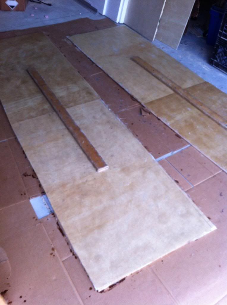

Test fitting 1/2" plywood flooring. Tomorrow I will start glassing it in.

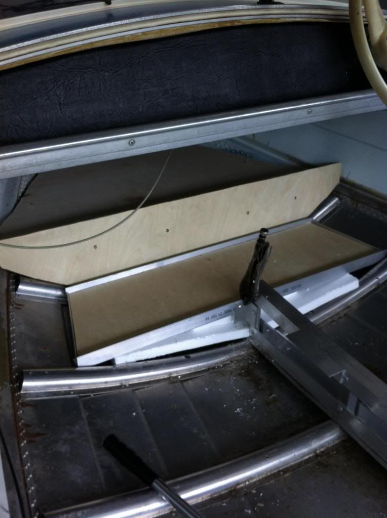

GA_Boater

Re: 1963 Jet Star rebuild
Is the floor sitting on the ribs or the chine ledge?
The weight will be transferred to the ribs and the fold at the chine.
I'm working on how to engineer the footwell and still maintain the transfer along the keel.
The reason I asked is because in the pic above, it seems the 2X4 is sitting on the chine ledges and stringer. So the floor is gapped above the ribs if I'm reading the pic right.
Correct, The center "rib" running the length of the keel will transfer the greater portion of the load.......that just struck me.. The original build has the majority of the underway load going to the sides several inches below the gunnel. So even with as stiff as its built the majority of the load will be going to ribs above the keel.....
Well the footwell, transom and sole is going better than the superstructure.....

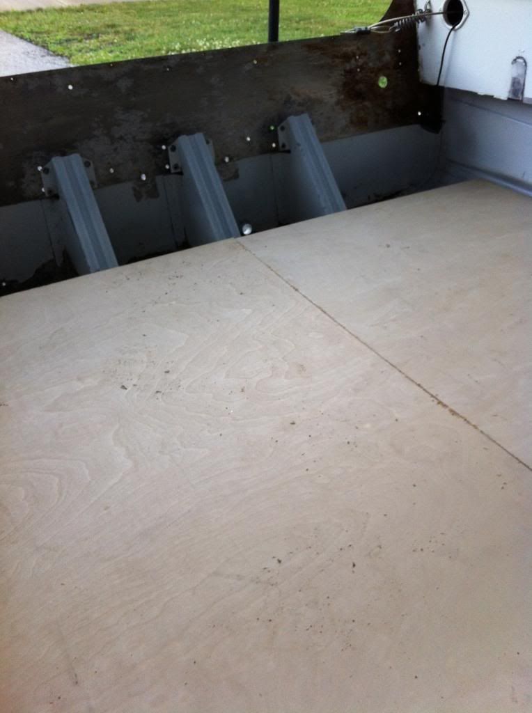

To explain the photos above,
I glassed the transom with 435 and 1.5 ounce Chopped Strand Mat, CSM, in the center and .75 ounce on the faces. The bottom of the sole is glassed with 435 and 1.5 ounce.

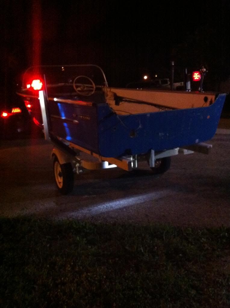

I have been feverishly working to get the boat ready for our trip, on the river to watch the fireworks, I failed to take pics... We splashed her last night! The break-in of the engine went well, she ran for 2.5 hours on 16:1.

She made her maiden voyage this evening! We traveled up the Scioto River to the downtown Columbus, Ohio to watch the firework show from the water.
I don't believe the 10.75" 15 deg. prop was best suited for the job of pushing her in a swollen river with @750 lb in crew and 100 lb in equipment and bottled water......maxed out at 12 knots.......but the skipper did okay a new prop purchase and the four of us had a great time.
