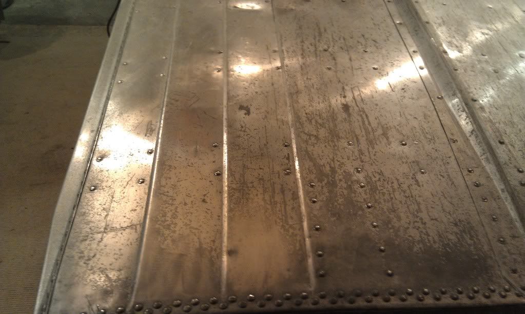

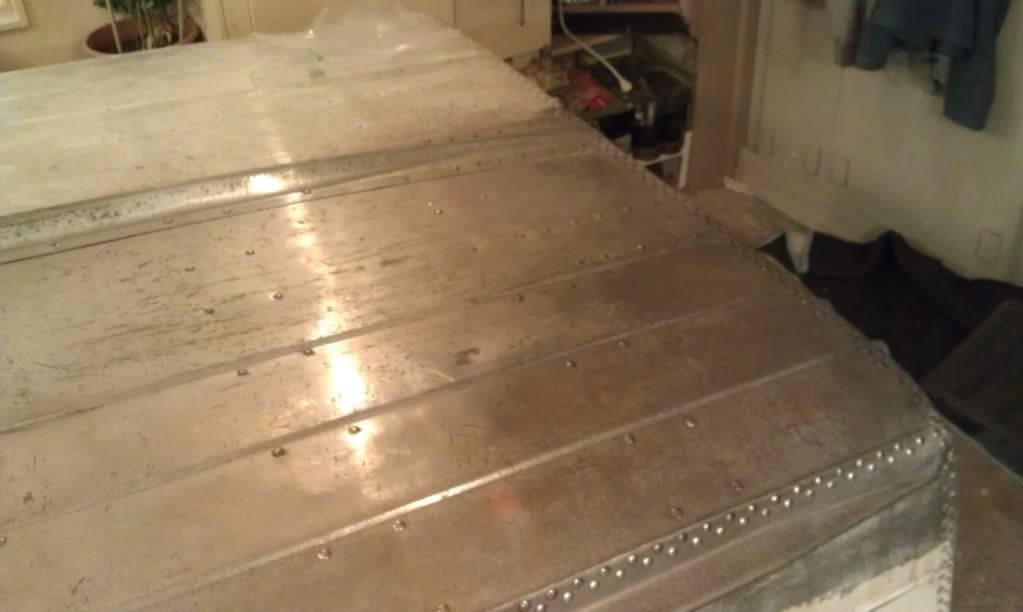

Well guys... it look super shiney until it dried... then I noticed it is actually quite dull... after 5 attempts to shine it up I concluded that I am going to have to wet sand it then polish it... unless anyone else knows what to do here.... the big issue is that wherever there wasn't paint, the aluminum is really tarnished and spotted. Soooooo.... I am tried wet sanding a small area and then polishing it up... you can see the smooth area at the back of the boat where I sanded it...
Any other idea's here guys are welcomed...

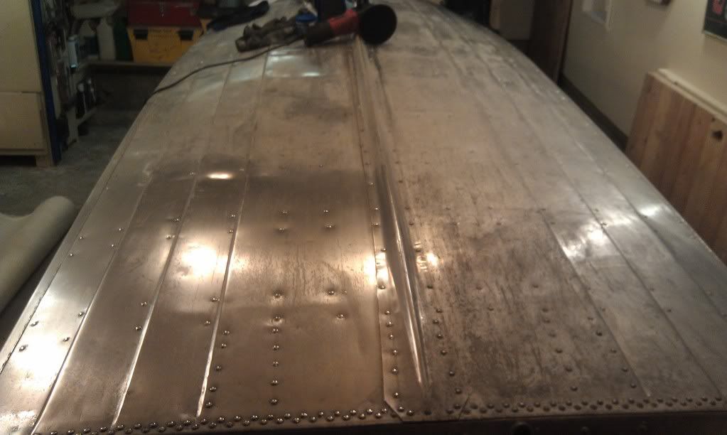

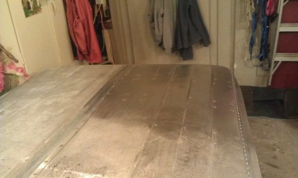

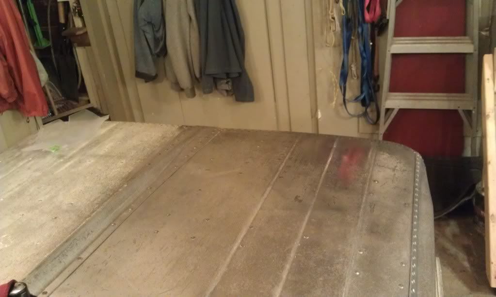

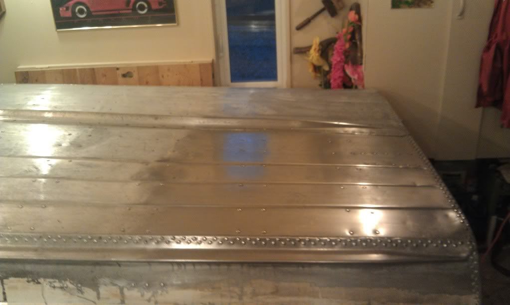

Sanding and Polishing Part 2a:
Ok... spent some time early am and here's what it boils down to: The aluminum is scratched and scored up enough that it is pretty rough in spots. So, I am doing what I did on JII --- 150 --> 400 --> 600 -->1500 wet sand to 3 polish coats and 1 coat of sealant. The following pics show from 400 grit onwards. The back is going to need 150 grit to get it to smooth untarnished alum and from mid hull onwards towards the bow 400. Above the waterline at the bow I will likely not sand as it looks pretty darn good already --- just polish and sealant. Sooooo here are a few shots of the test area:
In the 3rd shot you can really see the difference between the sides and you can still see the tarnished area on the left a bit where there wasn't any paint on the hull for likely many years.
Again... not going for mirror finish... just a nice, clean, consistent aluminum finish that with the polish and sealant should last many years --- well the sealant maybe a year or two.
