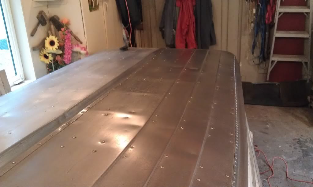

So I managed to sand one side of the hull --- 150 to 400 to 600 to 1500 and clean. Consistent would be the word I would use to describe the hull now. Perfect... heck no! But much improved. Tomorrow all being well, will be the other side. Then the polishing begins. For those that are interested in times to get hull polished and sealed: about 3 hrs of sanding and about 3 hrs of polishing + about 1 hr of sealing and approx. 1 hr of misc cleanup == total 8 hrs or so. Not sure what the prep time for painting would be + etch, prime and paint... similar? or longer?? Just curious.

I bet the total time for both would be real close to the same, by the time you feather all the chips, etch, dry time, prime dry time, paint 1st coat, dry time second coat.

SANDING COMPLETE!
Washed. Scrubbed. Ready for polishing.
Dummy me forgot to snap some photo's... so I'll snap some before and after shots tomorrow am.

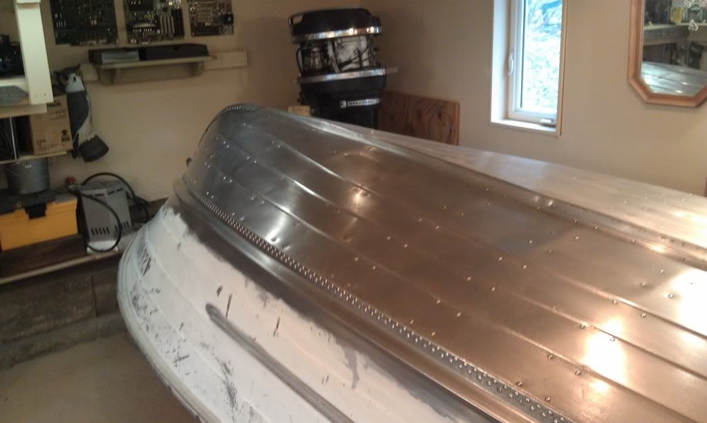

Ya... Ya... Doubting Thomas you! :)
Polished... one side!
It has more shine than it looks in the photo's in real life... but it leans more towards the satin side than the mirror finish. Big thing is: It looks just fine to me!
Tomorrow am... I'll aim at getting the other side done and then apply the sealant.
Before flipping it back over I need to scuff up the sides for etch/prime/paint readiness.

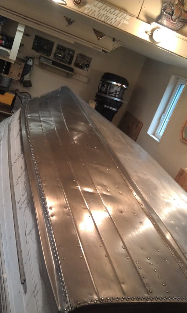

Hey fella's!
Quick update --- hull is polished and sealed and ready to go. Just need to do a quick sand on the sides so that they are scuffed up for painting in the spring and I will be flipping the boat over to be gluvitted!
