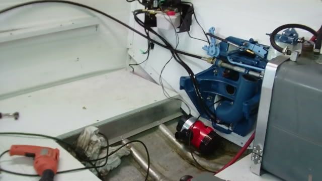

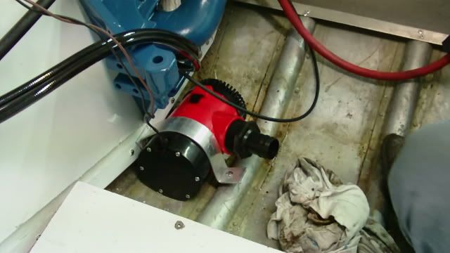

I would like to take the time to thank everybody for making fun of my pump.
Yes its a monster, I should of known better. But we learn from our Mistakes. In this case I still installed it. But I ran in to a problem As you can see I cant sit the pump straight cause its to tall. So,,,,, had to put it side ways.
As I said this is for when the boat is sinking from an extreme leak. I will have a 1000gpm pump right beside for the usual small to medium leaks. Had to mount the flywheel cover to make sure it would clear it. SO how to strap this pump? Glad you ask. I had plenty of aluminum flat bar. So went ahead modified this conjucture.
Drilled the holes to attatch the strap to the bottom of the transom and a rib.

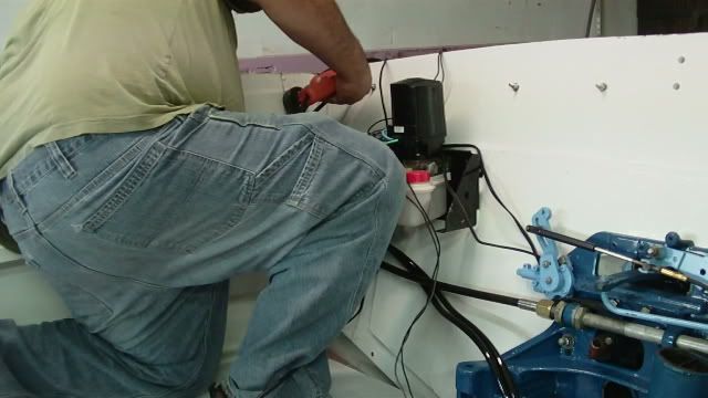

On the rib i used a rivet nut. U guys remember my floor braces, well this is the tool I used.
Drilled a hole on the rib & used the tool to install apermanent nut on the rib. Sweet.
This is how the nut looks like afterwards.

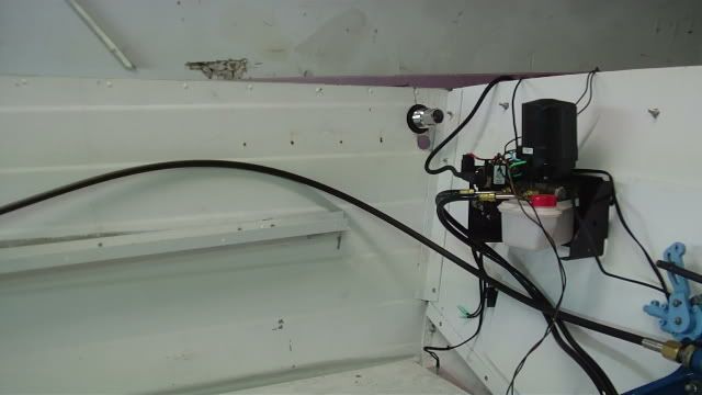

After all and done this is how it looks.
Went foward to install the thru hull fitting. Use a hole saw.
Large hole eh. the bottom hole is the original bilge hole wich I will install later.
Set and ready for the hose. Wich I dint have a chance to install But will soon.

Forgive me Azlo, but I'm fairly sure that your new mega-pump won't work while on it's side unless it's completely submerged and then as soon as it clears the water it starts sucking air. In other words, it will stop sucking at about 2.5 - 3 inches. That's still a lot of water! The grill on the bottom of the pump has to be immersed for it to empty the boat. Please let me know.

Thats the plan my kilowats. Severe leakage or sinkage is what it will be used for. Yes it will have to be submerged for it to work. Not intended for regular use. An insurance policy if u will.
If u notice here, water would have to be almost to the bottom of the stringers for the pump to work. Thats an emergency.
I will post a vid of it working. I coudnt find another way to install it. Plus I cant send it back so I have to use it, no matter what. For what it cost me I better.
Dude, no problem! What are iboats friends for?
Hey here is one quick thought...
Is that pump one that can have a hose hooked to the bottom? Like, take off the the strainer and install a hose running down into the bilge and within say 1/4" of the hull? Maybe mount the pump to the transom or something?
Just thinking out loud buddy. I know you have it mounted in there already but it needs to come out and be painted blue anyway, right?:D:D
Unfortunatly there isnt enough lip to clamp a hose to it, unless I can plastic weld or epoxy a longer lip. Hmmmm Now u got me thinking jasoutside, thats a good idea!!!
