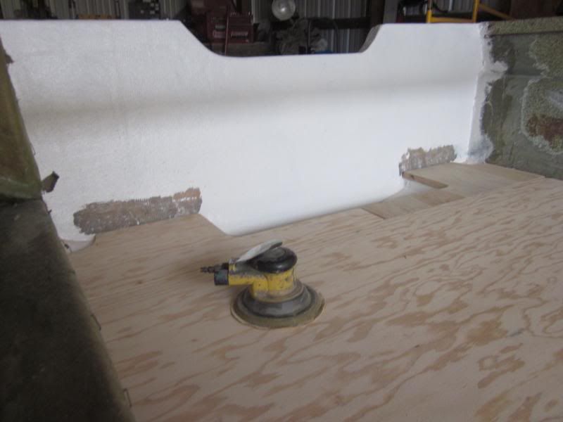

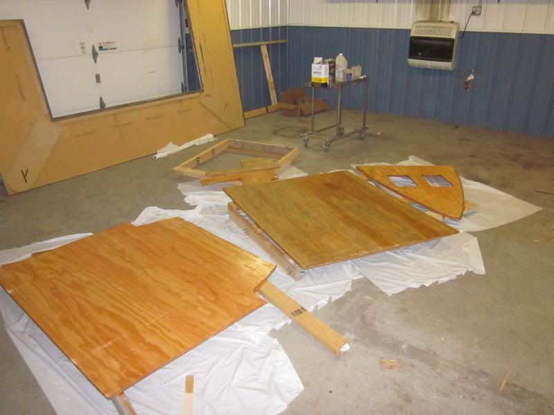

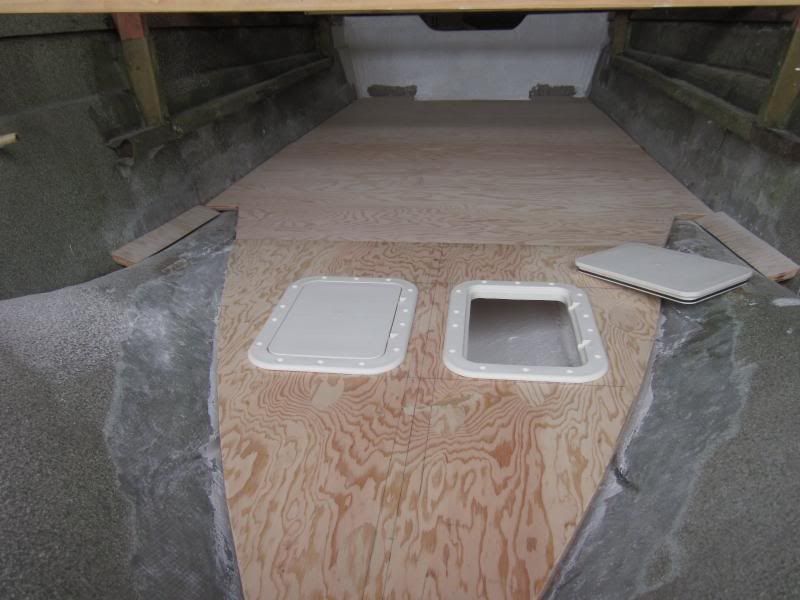

A good day today...Got the deck made up and fitted. I made the very last piece in two segments so I wouldn't have to cut into a virgin sheet of marine plywood. I love my iboats hatches but am surprised that they didn't come with templates. Posting pics is a cool thing because it is helping me be accountable and not take short cuts, lol.
I like to D/A all the edges and make the splinter free and smooth...
These hatches will be under the bow tub and behind the steps...

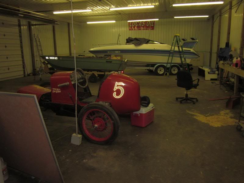

Moved the boat to the heated shop today. I'm trying to lease it so I may lose it at any time. My Grandfather's '25 Model T speedster in the forefront. Clocked at 70mph with a chevrolet overhead valve head adapted to the ford flathead block.
The paint room area. Needs cleaned up and set up but was able to get a coat of resin on the underside of the deck today...

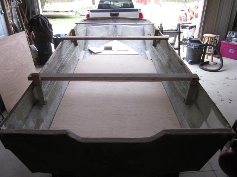

Nice work jc55. That floor looks great and the hatches are gonna work out good. I noticed the braces that you installed on the hull to keep it from flexing. At what point did you install them and how did you know where to set the width? Did you already foam the hull and I just missed it somewhere?

Hey Maryhannaj, no foam yet. The temp has to be high to meet the advertised expansion rate on the can. I may do the foam after I put the deck in. Gotta get the boat, foam, and shop acclimated for a day or two (natural gas ain't free :) ) before I can pour.
I took advice from another member. I marked the hull and cap every 18" with a Sharpie marker while they were together. Then I measured the width at those points on the cap after removing it. I reinforced the hull at specific points to retain those widths from the cap. I did not reinforce the hull every 18", but marking the hull often allows you options of where to place your crossmembers. I leveled the boat side to side before and after I removed the cap.

I don't think it really matters to be honest until you go to tab your floor in. Even then, my boat is rigid at the chines and there isn't any play there. You can just measure starting at the stern while the cap is off if it concerns you. Putting stringers in level and without twist in the hull I would think is most important.

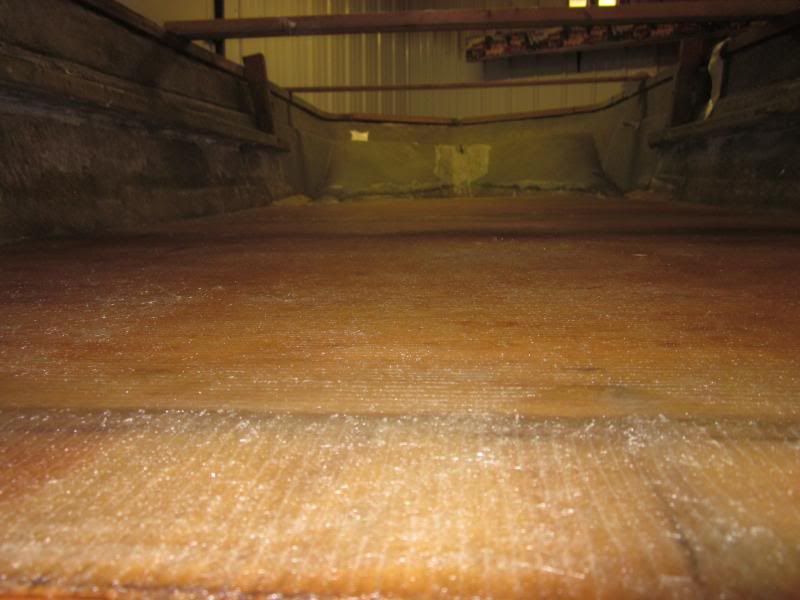

Back at it today...I'll explain my "deck screw epic fail". I bought 1-1/2" brass screws to install the decking. $30 worth :( Got everything ready, layed down some PL on the stringers, drilled pilot holes for each screw, started putting screws in and...SNAP! Tried it again...SNAP...redrilled pilot holes to the entire length of the screw...SNAP! Glue is setting up, I'm 14 miles from the nearest store and can't find my stainless screws anywhere. Drilled larger pilots through the deck then the smaller pilot holes in the stringer...SNAP! Finally did the above and a light coating of TAP MAGIC on the threads...bingo. Note to self...only use stainless screws from now on.

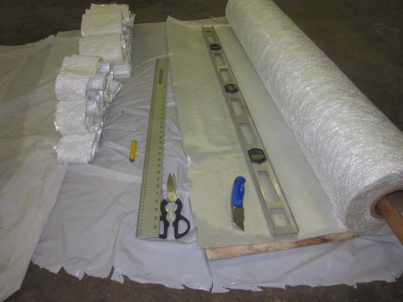

Got quite a bit left of a 115lb roll. I bought 1708 only for the entire project. Got my tabbing made up for the decking...
Made some last minute floor reinforcements...
Went Cabo-silly on the installed deck. I use Tractor Supply syringes to apply the PB mixture.
Started the tabbing with 3", then 6" of 1708...
All seams and sides double tabbed and a final layer of 1708 over the whole deck...

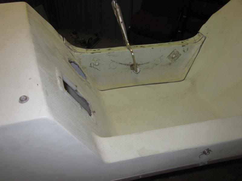

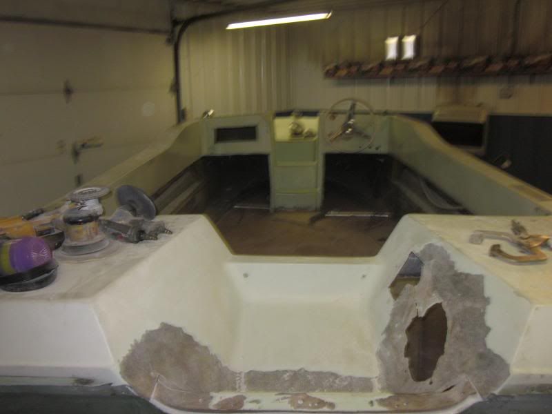

Well, tried a final fit of the cap and the splash pan hits the transom and won't allow the cap to come all the way to the rear. I think that perhaps the transom is now thicker? I don't remember the exact thickness of the original. So I cut her to fit...

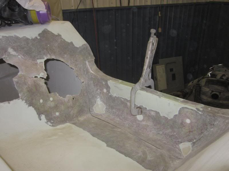

There was a screen and bondo patch over the steering cable hole which I ground out top and bottom...
From underneath...
And MHj, Hey man, I don't know if I'm the one to be giving much advice but I can take a pic of the supplies!
My question is, Does every bit of Gelcoat need grounded off before applying poly resin and mat? Will resin adhere and feather over Gelcoat? I ground out the splash panel corners all the way after this pic. I want to build this back up with 1708. then sand, epoxy primer, and paint.
Also, I've removed about 50 cover snaps all over the boat. Do I have to scarf every rivet hole or can I use epoxy resin and a syringe to fill these holes if I'm painting the hull?

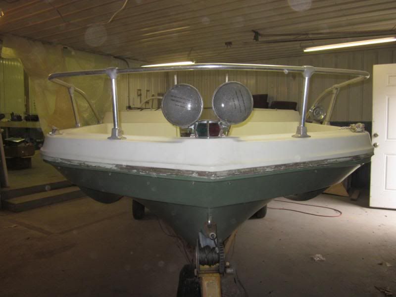

I scored some vintage looking lights...honest opinions please if they look dumb(stickers on lenses come off. I'm hoping these fit my work boat theme...
