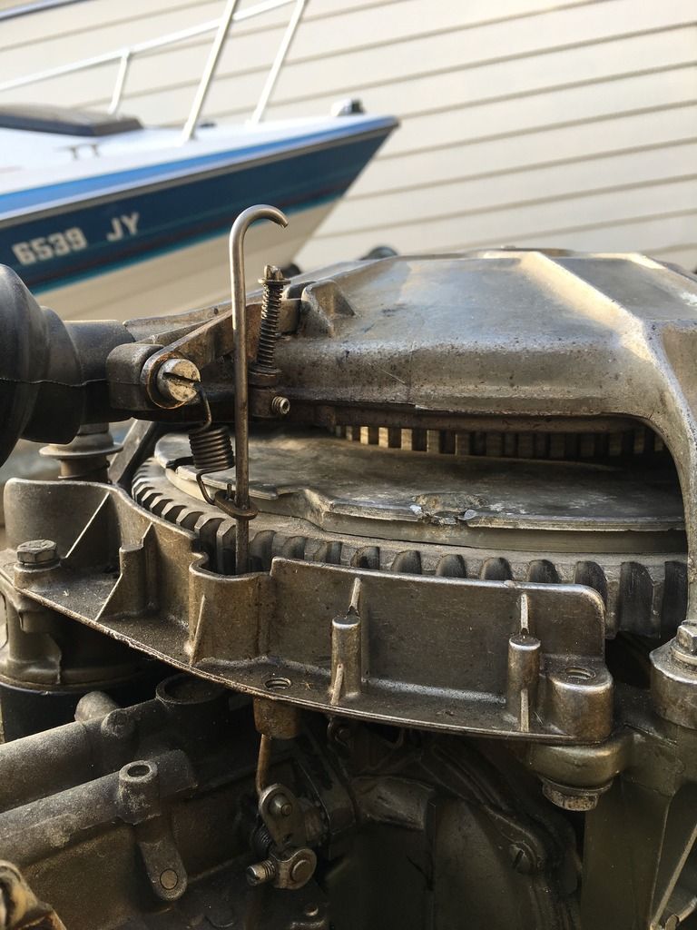

Pic of broken piece from timing advance?

rod from cam follower to locking lever -- believe that's part of the starter lock system, limiting ability to pull it over if the throttle is advanced too far. I see flywheel damage, probably from a prior attempt to pull it. I would consider that a serious issue (dangerous issue).

The guy said the piece that is broke happened recently after he took it out of storage. I seen the chips in the flywheel, I was wondering how it even got damaged bc I don't see where anything would hit there.

The broken linkage is indeed the recoil interlock. Currently the recoil is probably locked up.
Chips in the flywheel? I can't see any in the pic, just a combination of lighting and dirt making a cutout/bolt hole look nasty.
