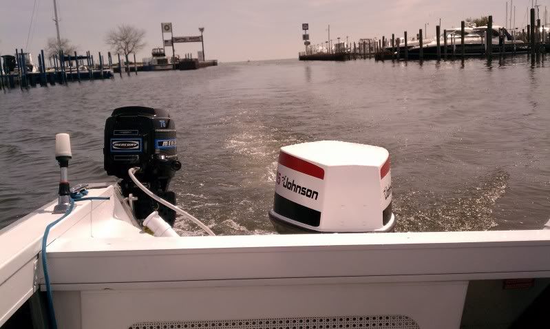

I'm looking to do the exact setup on my SS. I've got my short shaft Evinrude 15HP and a ridiculously beefy stainless adjustable kicker bracket. I'll be mounting it in pretty much the exact same spot because I'm putting my swim platform on the port side (due to their already being holes their from a previous platform and believe or not they actually line up with my new one!).
One thing you'll need to keep in mind is the transom wood brace under the splash well. After measuring 3-4 time I was sure I'd miss it, however I was 1/8 too close and wasn't able to turn the nut on one of the mounting bolts. It took me longer to grind out a notch on the brace the it would have to just fill the hole hand drill another.
Also, even though the instructions for the bracket were fairly clear, I would have liked to mark the water line on the boat and installed it based on that point. Like I said earlier, I think I'm about a inch or so to high, but only a trip to the lake will confirm that...
