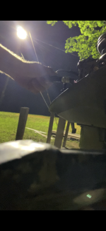

I’ll clean it up first thing in the morning when I can see what I doing but I’ll let you be the judge of my spark. I think that’s plenty of spark. That’s plug #1

Maybe it’s just me but your spark is very yellow and looks weak. A good cleaning of the points and everything else around them may just get you going.
39,345
Does spark jump a gap of 5/16" , yes or no ?-----Using a spark plug to test for strong spark is a waste of time.
