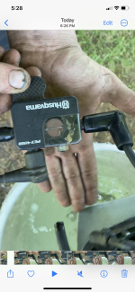

In an earlier post you said you had not checked the sparks on a tester.You MUST do this as you are not getting any sparks and as previously mentioned holding a plug against the block does not cut the mustard.Also I would fit new plugs,Champion 4c4 I think are the right ones.Good luck.
Give me just a moment and I’ll upload a picture of the gap tester and spark and you guys tell me what you think?
