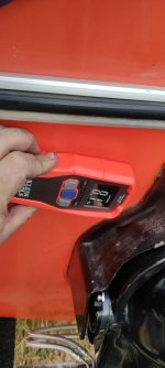

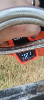

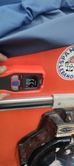

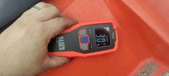

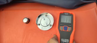

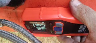

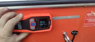

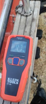

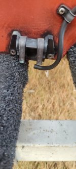

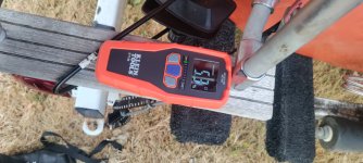

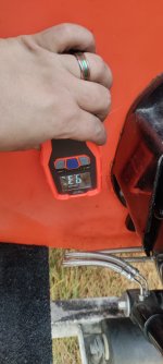

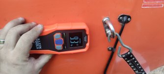

As promised, I obtained a moisture meter. Attached is what it says about the transom.
At the fuel filler (known to be very dry) I'm getting about 4.5%. This jumps up to 8% below the bumper, gradually increasing up to a peak of 11.5% at the bilge plug. Also of note is that both swim steps are around 5%
Yes it is technically wetter at the bottom... But not to the point of being "Wet"?
