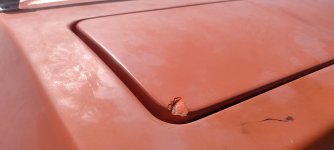

  • Went to re-caulk some rubrail/hull/deck gaps, and discovered several rubrail screws had come loose:
    • I was able to pull the rubber and tighten most of the screws. I had 3 or 4 that spun, but surprisingly all of them were in areas that weren't gapped. I pulled these screws and didn't observer any signs of rot (clean stainless, no staining or debris), but put them back in to avoid leaving holes
    • Did see a couple spots where it looked like screws had been removed and moved/redrilled 1/2" over. Maybe spun screws from the past?
      • It did look like there was a hole in the gel coat too. I might hit those with the UV4000 while I have it out?
    • The rubber was very stiff... no idea if it's original. Or if it will go back in. Should I look into replacing it?

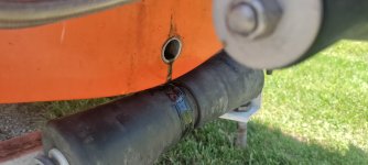

  • Bought supplies to remove and fill in the holes for this defunct pitot tube on the transom:
    • Plan will be to chase the holes with a drill, countersink the gel coat, then fill the holes with six-10 followed by a gel-coat repair kit.
      • Since pre-tinted gel coat for this boat isn't available (and I'm cheap), I'll be going the generic "mix it yourself" color blend route. Whatever gel coat I have left over will be used to patch various bits of dock rash elsewhere on the hull.
    • I don't ever see it being used since it interfered with the trailer (to the point of ripping and rotting the one bunk) and that I'm running a GPS speedometer.

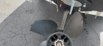

Had the first outing today. Hit up Lake Waveland. Writing this while stopped on my way home.
Mostly went well, but there's some issues. First, the shifter cover popped loose on the highway this morning (bungee cord elasticity failure) and took a chunk out of the gel coat (I have a generic gel coat kit, guess I get to use it). Then, we hit something in the middle of the lake that made one heck of this... Chewed up two prop blades and nothing more. Finally, I noticed some oil in the bilge before the outing, but didn't write it up as important. But after the outing, there's a decent amount of it in the bilge and our the drain. Based on smell, it is outdrive oil... Guess I get to pull the outdrive and service the input shaft seal? I did change the oil... Other than a muff test in my yard two weeks ago, this outing is the only use it's had on the current oil.

I have a theory on the oil I found.
First, I check the oil level at the vent plug... just below the plug , where it was when I changed it. Oil still had some of it's blue tint, not the black/brown (no blue) seen coming from the bilge. Also, the smell was stronger of sulfur than what came out of the bilge.

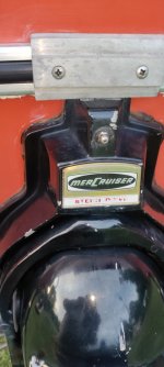

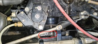

I then pulled the shifter cover (the one that had the bungee failure) and found something:
The area circled in red (transom plate) was covered in grease of a similar tint to the "oil" that came out of the bilge... somewhat similar smell too. Sadly, also had a bit of aluminum flake in it too. Note that the drive shaft is dry...
This was the point that I remembered that I greased the snot out of the upper steering pivot this spring (and last offseason too)... and all that grease (and aluminum) was what got shoved out when I topped it off.
It has some slop... had slop when I got it. From what I've read there isn't a bushing there... so short of replacing or modifying the transom plate, that's not really fixable.
In any case, I wonder if the junk that came out was diluted grease (and/or oil separated from grease) that got pooped out of the joint due to excessive greasing by yours truly? Or at the very least, keep an eye on the next outing too see if there are any more issues?
