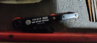

A particular tool I bought and deserves special recognition is a Japanese low profile ratcheting screwdriver (Engineer DR-55) for getting to the console screws:
Despite a coarse tooth count it has a very light backdrive and it worked way better than expected. The thumbwheel is also more useful than expected, especially for starting screws. Would recommend for anybody else wanting to pull a console without removing glass.
