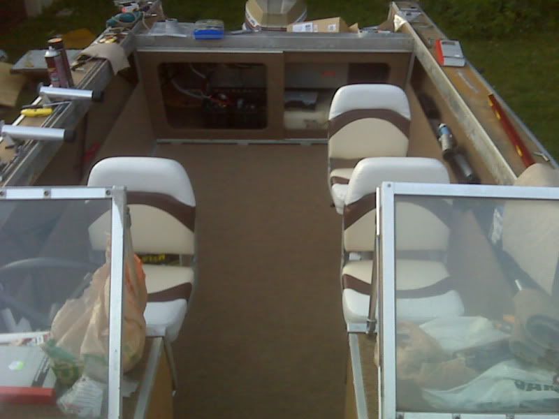

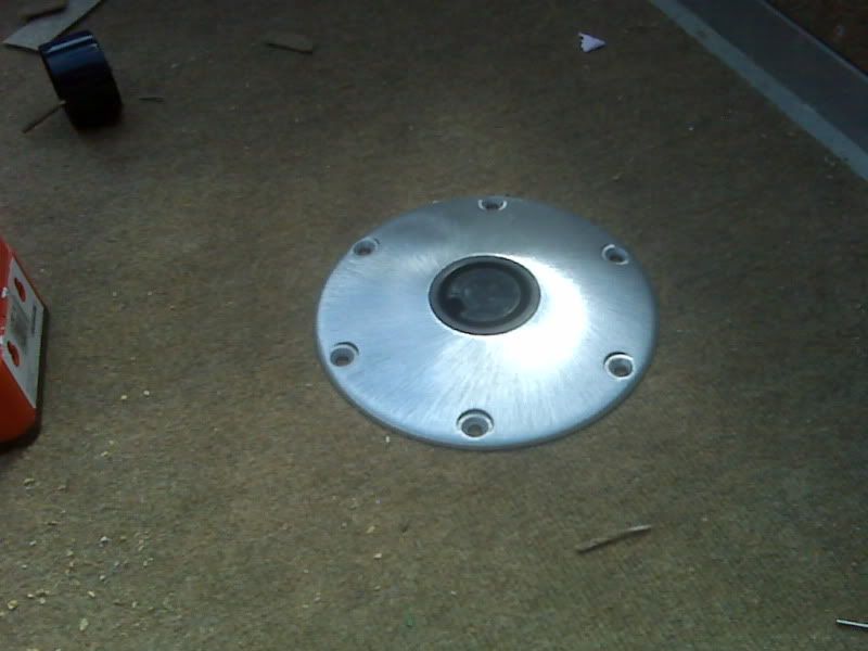

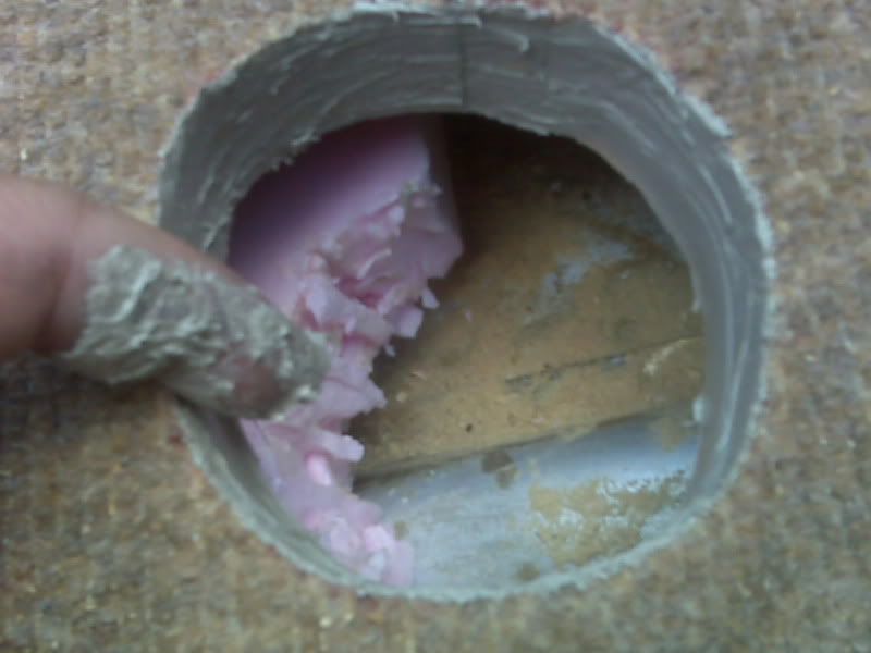

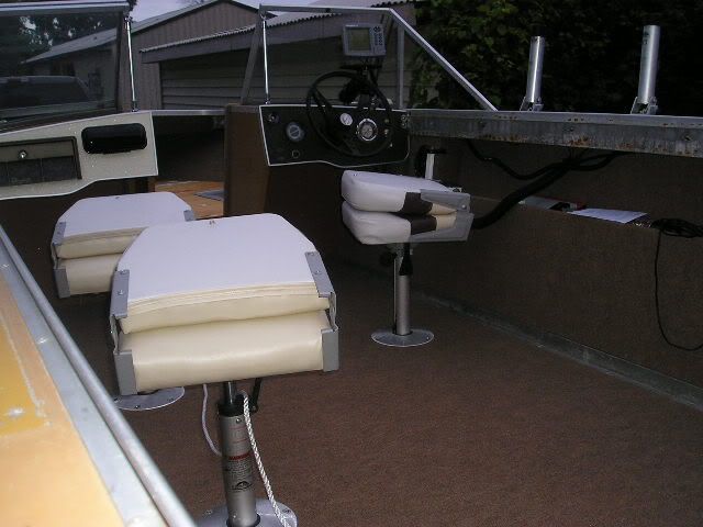

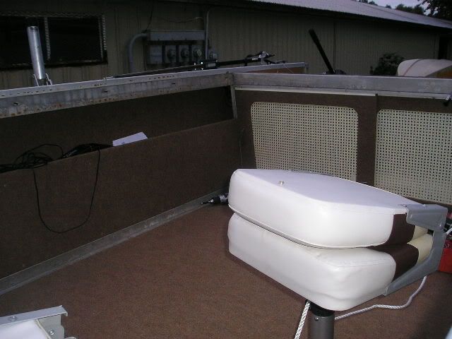

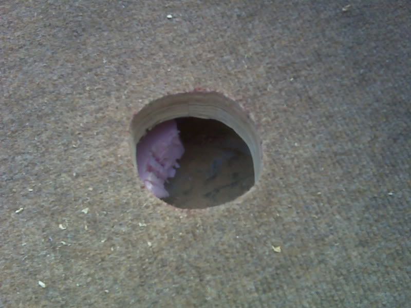

time to mount some seats and pedestals! using flush mount bases i needed to carve out a hole after about a hour of debating on position i managed to scroll out a hole with the jig saw then seal the edge with some osi caulk (polyurethane adhesive caulk) then mount the base caulking each screw thread to help seal the new holes.
then voila seating is installed ill be adding a fourth seat at a later date for now 3 will do!
