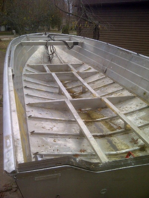

This pour in foam is everywhere and sticks to everything. Even before I knew about limber holes it is painfully obvious there is no way this design would ever drain. The pressure washer comes out to try and blast off the last of the foam, clean up the bottom a bit and see if can blast under the ribs to open.....the limber holes.
Starting to get a bit concerned about drainage down the road. Not a lot of room under the ribs and not comfortable drilling holes thru the hat channel, especially at centerline as it is already cushed from forming die....
Will keep cleaning for now and do some searchin on other rebuilds.

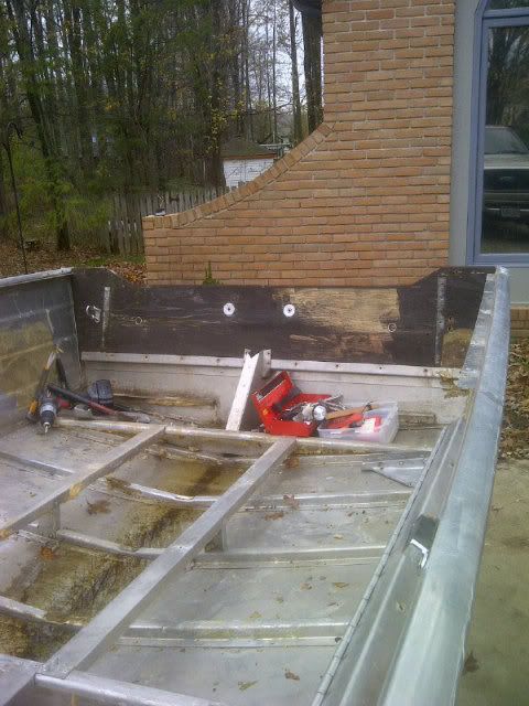

Transom Time:
By this time in the process have lurked enough to expect the mulch. I have been picking at it with some pointy tools and seems solid.
Matter of fact, It seems really good so sand a bit (lighter area in pic) and looks good.
So, off with the obligatory 100 screws / bolts. I know when the cap comes off the top it will be mush....
Hmmmm, no mush. Solid.
So lets get this thing out and I am already looking up to see where nearest tree limb is but lets just see what happens.
Nothing, wont budge. Double check for more screws and yup, guess my crew didnt hear the order to remove the thru hull splashwell drains. Oh, oh ... the crew was off today so dont have to look much further than the author. Dummy.
And so the transom slides right out. No mush on bottom edge and they actually did a nice job making this. There is not one perpendicular edge so everhthing is a combined miter if that this the correct term.
Still going to replace it but maybe clean this old one up and find a home for it in my bar, or as it is known "The Long Oar Bar".
The aluminum cap is not cracked or corroded, beauty eh.

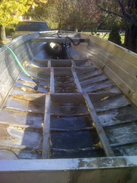

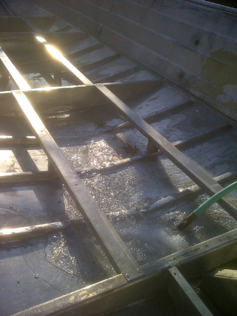

So start filling her up to check for leaks. Heeding the cautions from others not to overfill, get carried away and bend her up she starts filling up.
not too much now
yup, she's a leaker
not good pic maybe you can see drip line
mark the leaking rivets & seams. flip her over and look closer
not bad I am feeling comfortable with all the info here on rivets. no bumps, depressions, hull looks good. po obviously thought rtv silicone was saving grace and then maybe some marinetex but doesnt look bad
I do some scraping, some power washer blasting and this should clean up relatively easy. Still happy with boat and enjoying the project.

Goo and paint on the outside just doesn't stop leaks as well as a lot of people think it will.
I'm not a big fan of the fore to aft stringer design in aluminum boats, especially with that light channel design. That's the reason they filled your bilge up with expanding foam, to give the decking the support the framing couldn't.
I suggest going back with a good grade of 3/4" decking.

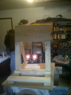

I get the engine stand plans from sitcky notes and buy up supplies based on the BOM provided. Sure makes life easy. Lay out the boards for cutting. My retired Sandusky pal comes into town and gives me a hand cutting and shooting screws. Close up the garage door, fire up the heater, go at it.
Looks like 2 huge bloodshot eyes watching the work eh.

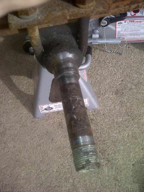

Time to check out the trailer hubs, bearings, seals and lube. In the way back machine I worked at a bearing mfr. so fairly curious what will find. Previous mentioned found a lot of old grease on inside of rims so thinking po kept shooting a lot of grease into the hub and out the seal.....
First bearing buddie off and this gray lube kinda just starting to slide out of hub. I dont like that but lets get hub off.
While at bearing mfr. developed good frinedship with fellow responsible for failure analysis. Most of the time it was straightforward:
lack of lubrication & contamination. I saw a lot of failures and came to see how what at first thought was just dark staining was actually the beggining of rust. Under the microscope it was very clear. Also came to appreciate how many different grease were used. I think we had over 50 different types in stock depending on application for the bearings. Keep in mind at that time the synthetics were not in vogue yet.
So dont know if this thin gray lube is synthetic or just cheapo stuff but dont like it. I pull the seal, very cheap, sinlge lip, half case, no garter spring. Bearing cups and cones were made in China and obviously were not original to trailer.
Go to local marine store and auto parts store, all they carry is the same offshore seal and bearing combo.....so thats what it will be.
One spindle show some signs of pitting and staining.....remember what ole Neil said "Rust Never Sleeps". Other spindle was:
I was most concerned about spindle surface where seal rides and after some clean up and emery cloth found it to be acceptable. I considered shaft savers but ended up passing.
New lube, nice and sticky for hubs, bearings and seal surface. Install, adjust and good to go.
I learned that the application for a boat trailer is not a healthy environment. As a fellow mentioned over in the trailer forum, sorry couldnt find him to give him his props, it is just Physics. Trailer boat to ramp...nice and warm hubs, bearings seal......dip the trailer in the lake and a vacuum is created where the cold stuff wants to make friends with the warm stuff in other words get past the seal.
My Pop and bearing friend got me in the habit of checking the hubs an least annually and moreover any time out on the road. After 5 miles or so just stop and touch the tires and hubs. You will discover if they are running nice and cool or if theree is some serious heat building up. If heat get some help soon.
The traditional failure is when the bearing gets so hot it actually welds to the spingle and then boats and trailers all over the highway.
So if you get in habit of checking frequently while on way to ramp, trips let alone annually pulling hub your life will be relatively easy, imo.

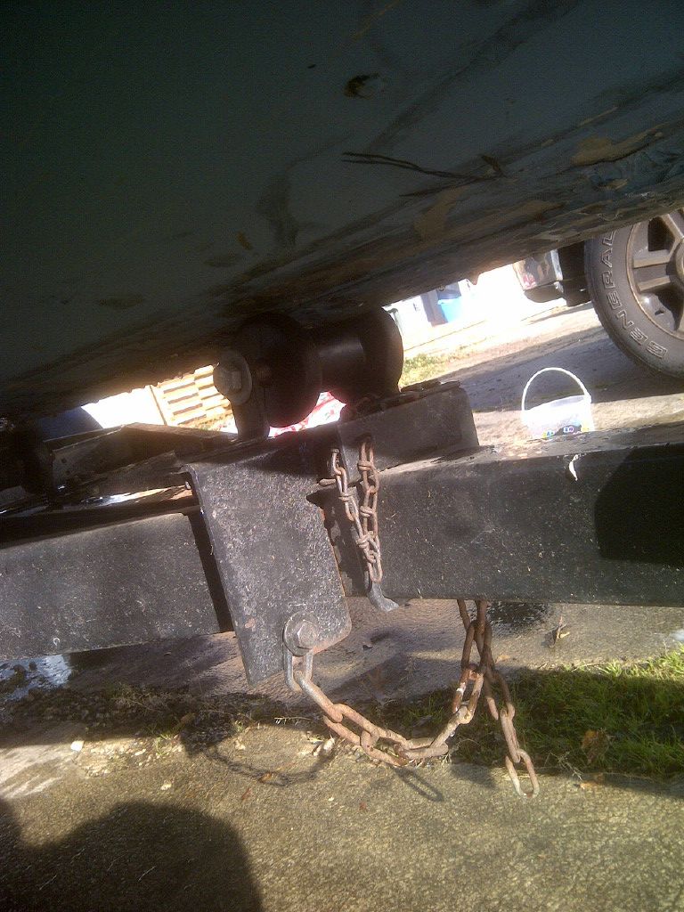

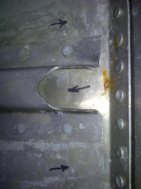

I had finished the hubs and was picking some leaves out of the hull feeling pretty good. Leaning on the gunwale just looking over the hull and right below my chin is what in the world but the crack:
All in all not that long. Thinking fairly straight forward to fix, drill some stop holes, probably patch with alum piece from underneath with rivits and 5200 but may as well look over rest of hull a bit closer, especially end of ribs. Nothing comes up.....
I remmember seeing Grandads resto and his boat is similar and his hull crack was in same place although significantly longer.
Mostly what is bugging me is why this happened. No dings, dents, bruises in that area, in or outside hull.
It sits just about halfway between the consol and capt'n seat so maybe some stress from grabbing on, sitting standing ???
Will stroll over to Grandads and review as seem to remember he had an opinion as to why on his hull.

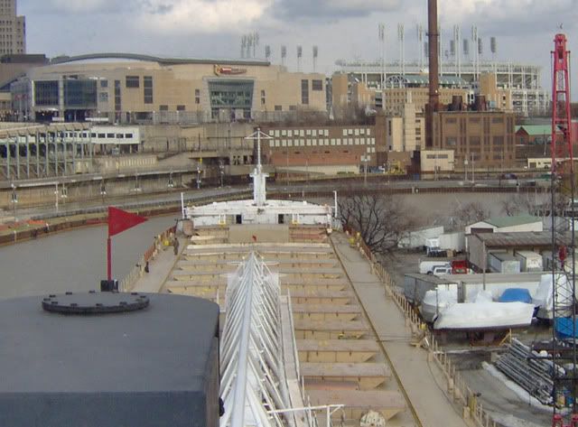

I have picked up on the common vibe that is being laid down that it is important to do some sittin and thinkin. As my thread is just about current, weather is here I will some of that sittin/thinkin and get an updated to do list going.
Here is where I sit to accomplish this task:
Wonder if any of the local boys will be able to pick up on the location.....
Cant you just imagine how many lines we can put out when that boom is swung over the side:rolleyes:
Please have a Safe and Happpy New Year All.

Carp,
I grabbed the wrong pic. Still stuck in the thread catch up mode. Meant to use this more current pic
The one with the mighty Cuyahoga frozen over. Common on now, who believes a river that can freeze would catch on fire
