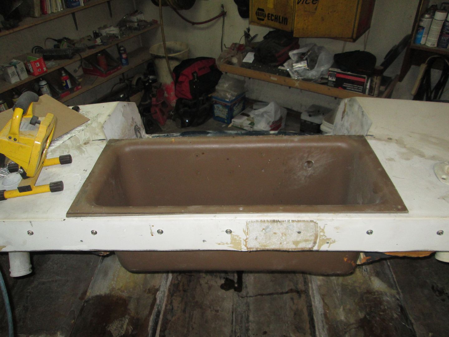

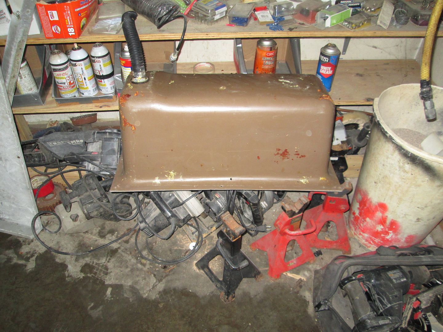

Today's progress:

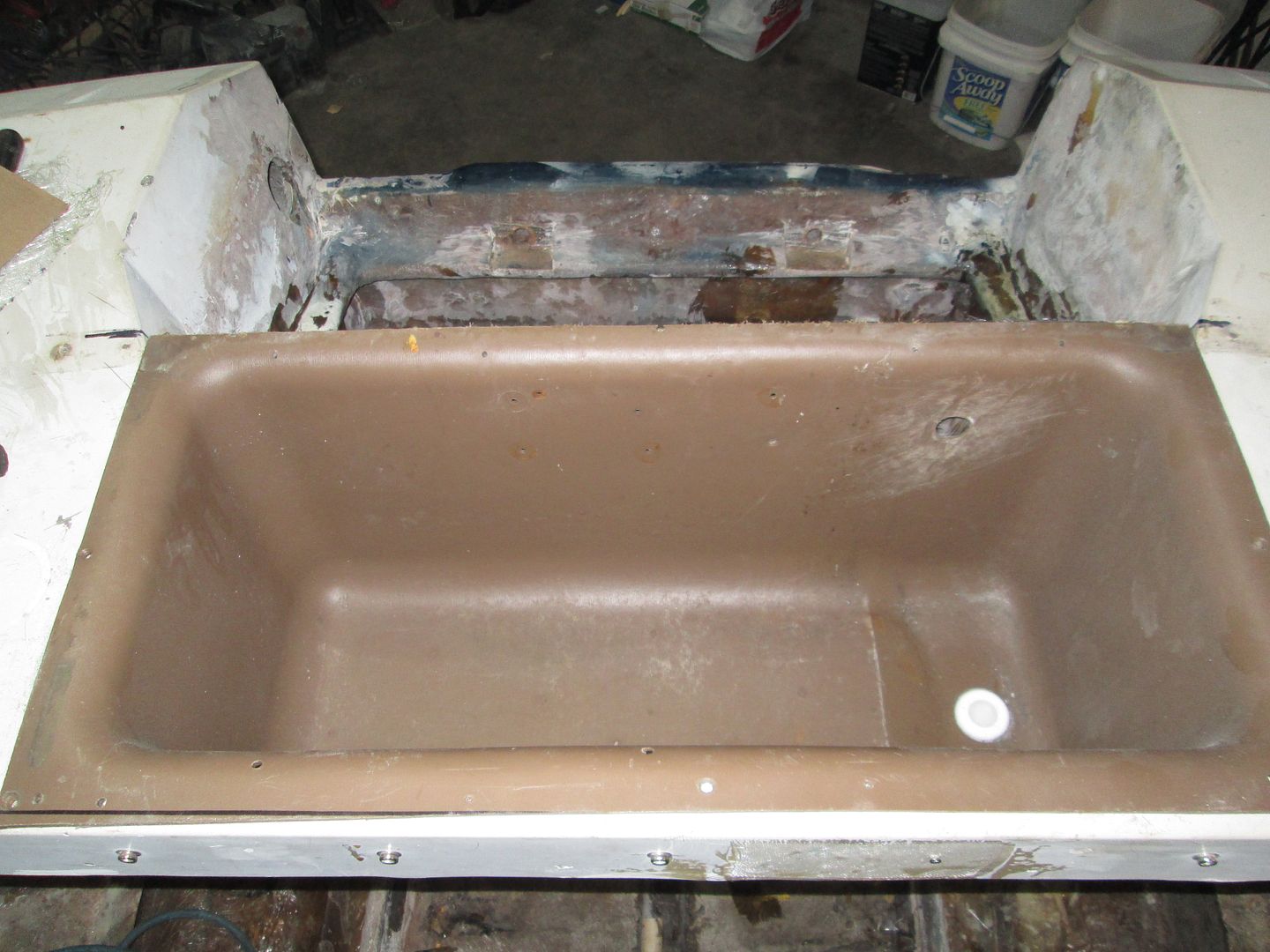

Livewell removed from splashwell:
The livewell itself:

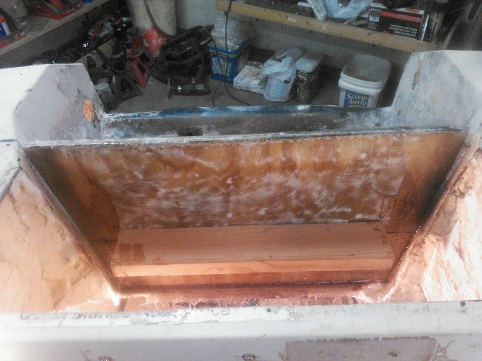

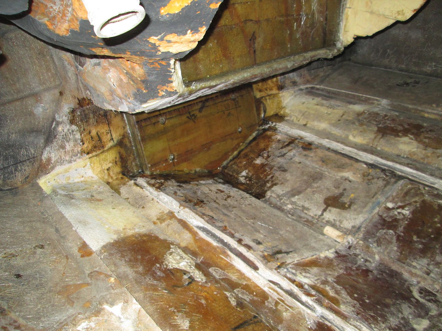

More progress made this week:

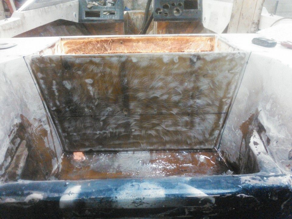

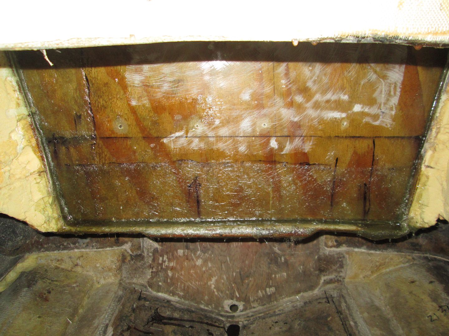

Back wall of the livewell box cut, fiberglassed with cloth, screwed into place and fiberglassed on the backside with CSM, side facing the transom will be PB'ed and fiberglassed in with CSM and cloth.
Back side of the back wall
The 2x4 will be removed prior to installation of the well.

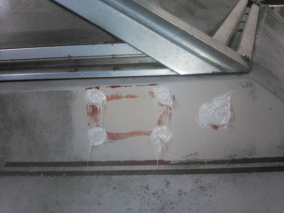

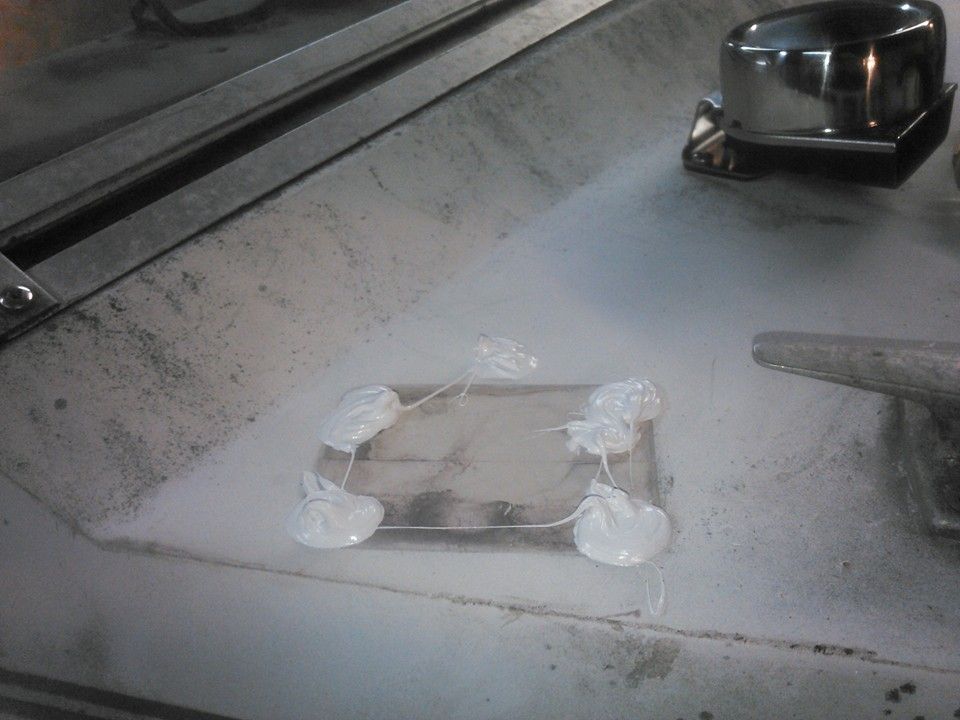

Filling old holes with Life Calk:
I used blue painter's tape on the back side of the larger holes and I will be cutting the calk flush with a razor blade once it cures.
Fiberglassing the back wall of the livewell box and a new piece of transom wood for under the splashwell that will be tied into the new stringers.
Like I said in an earlier post, my dad and I are not totally restoring this boat, just refurbishing it to the point where it is structurally sound and can be used to go to the beach, take it fishing, etc

sphelps
Nov 16, 2011
11,508
I was just thinking on the caulk that you used to fill the little holes ... You could have dremeled a little V groove and used some structural filler . Sanded and touched up with some white gell ... The color would never match perfectly but would hold up much better than the caulking ...
Just throwing it out there ..
Woodonglass
Dec 29, 2009
25,932
I agree ^^^ Life Caulk is good stuff, but...not really appropriate for this application.

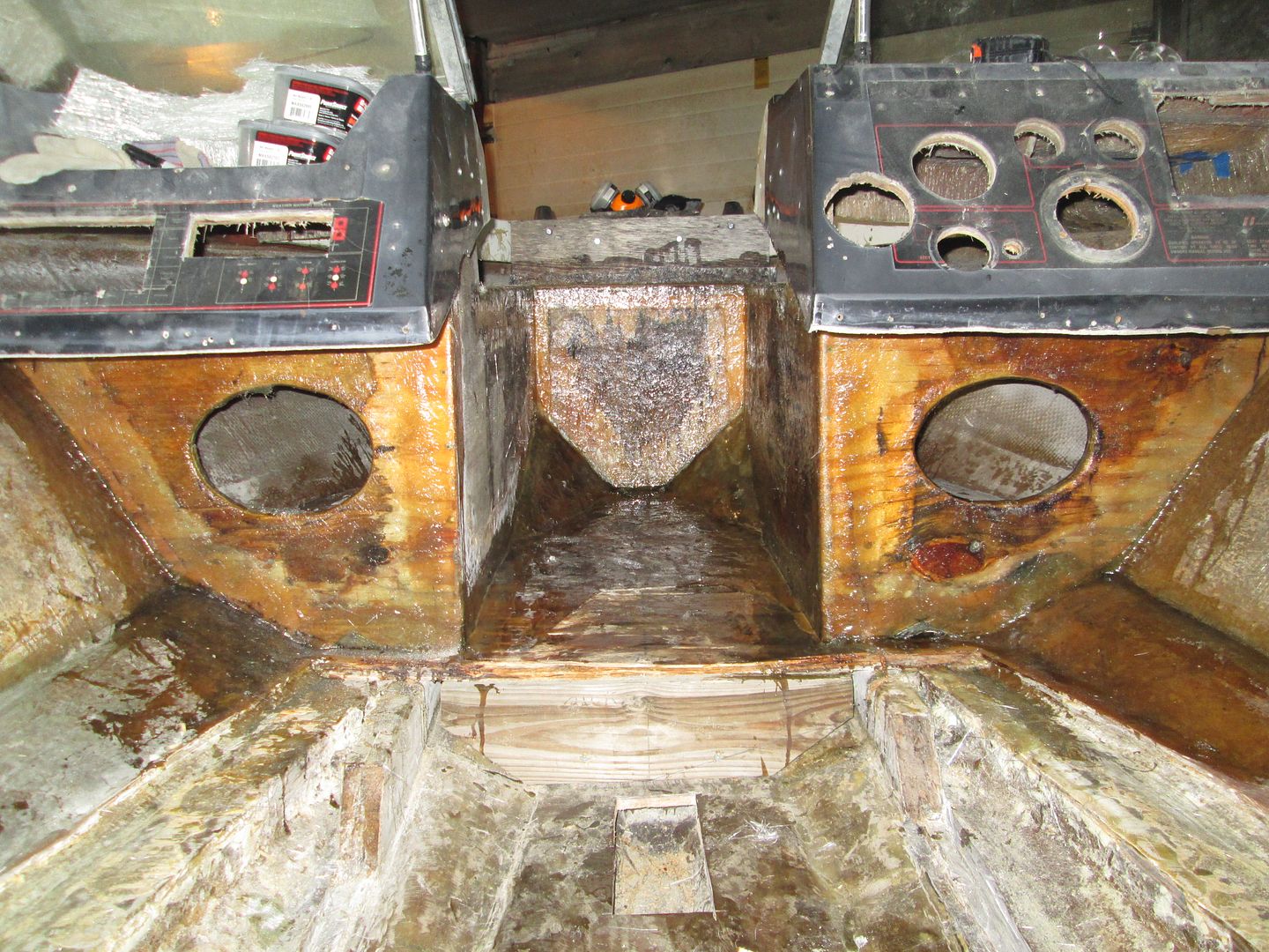

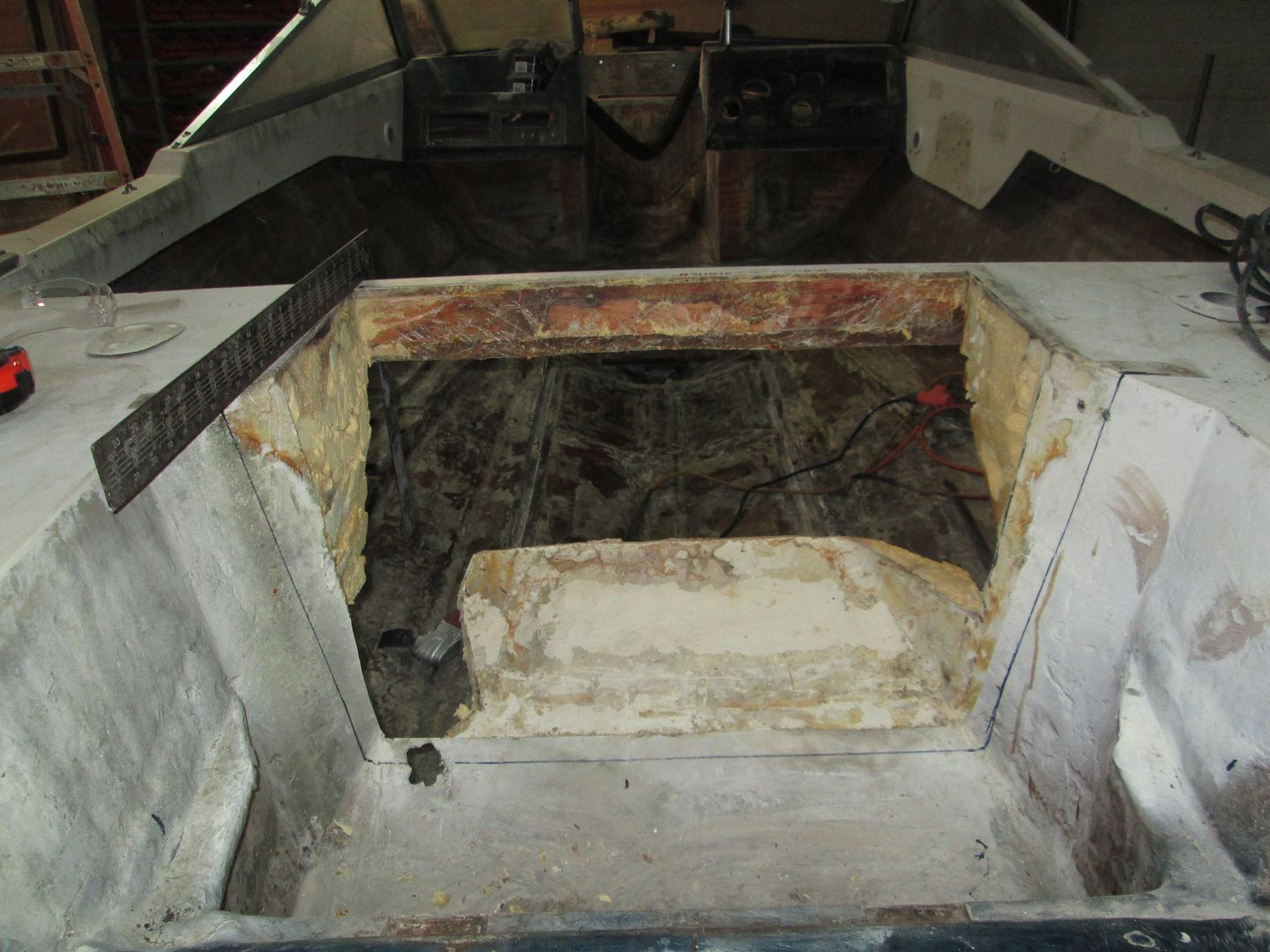

More progress today:
Final layer of CSM on the backside of the new bulkhead for the splashwell:
1st layer of CSM on the customized bow area:
The 2 holes cut are for a pair of 6x9 speakers for the stereo.
Livewell mocked into position:

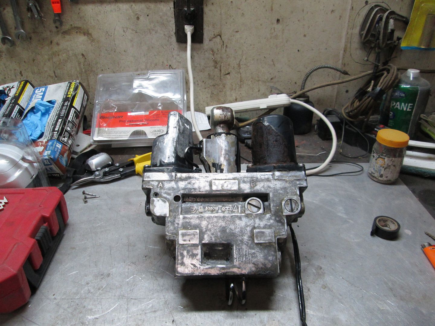

Trim and tilt unit cleaned and prepped for primer, paint, and a new trim motor:
Woodonglass
Dec 29, 2009
25,932
Uhmmm the strength of the transom comes from the tabbing to the hull. I don't see any. Are you planning on it??
oldoutboardkid
Seaman Apprentice
May 9, 2008
33
Yes, need to pick up some 1708 first, as well as some cabosil and 1/4" chop strand, luckily I have a fiberglass supplier (LBI fiberglass) close to where I live.

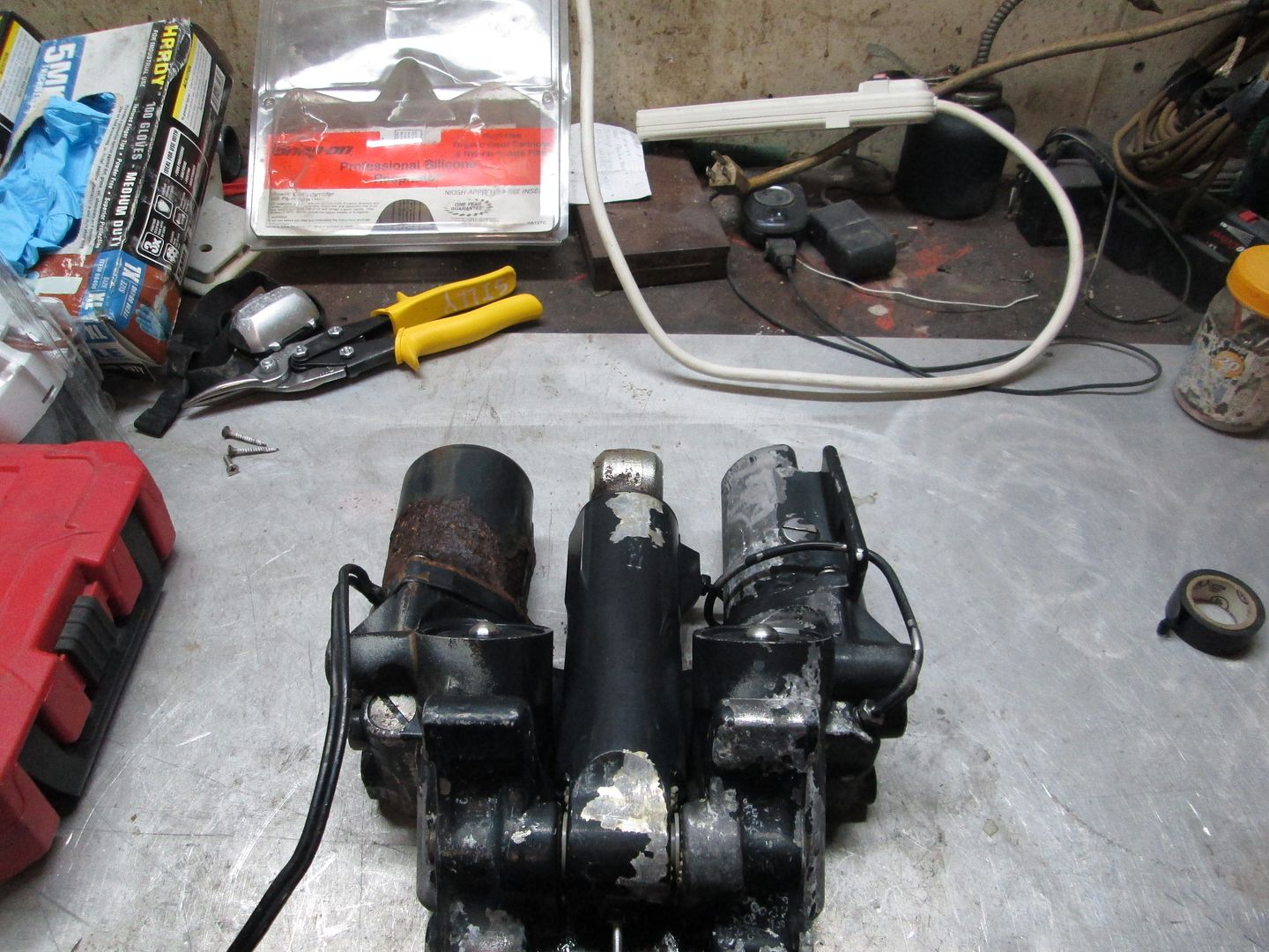

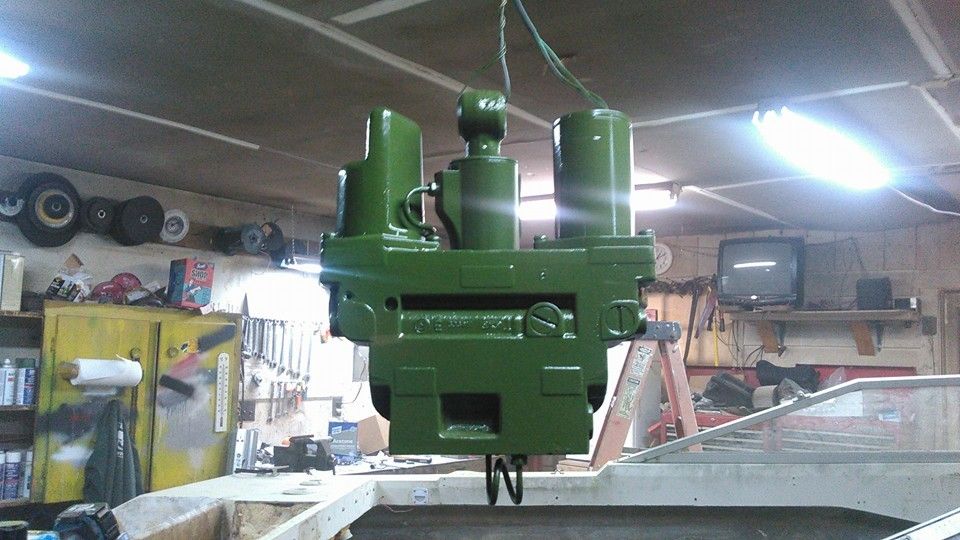

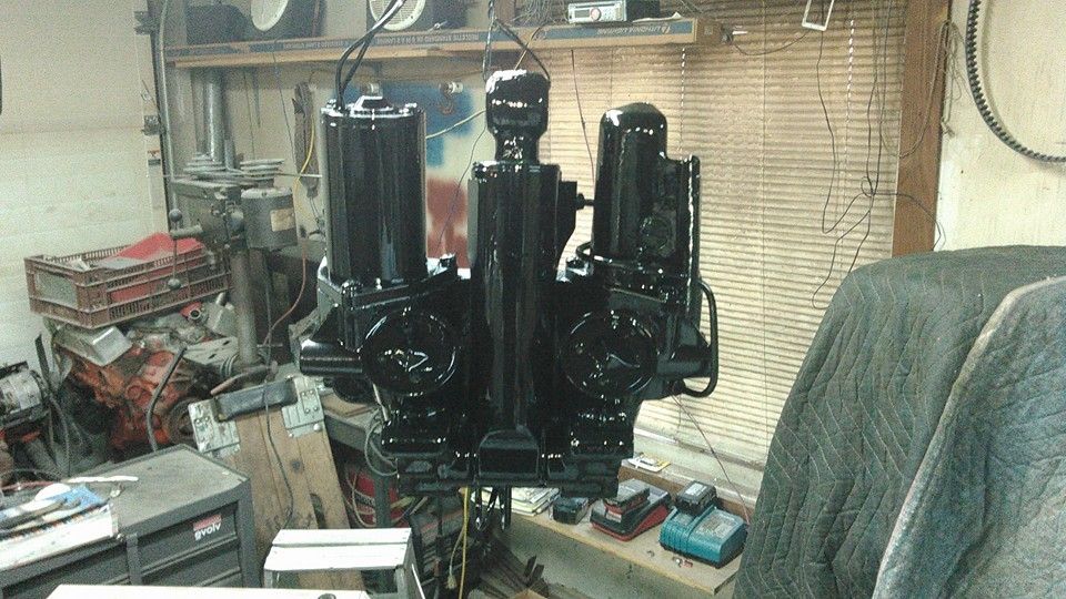

Since my dad has not been feeling well recently, and he is doing most of the fiberglass work, I have decided to get some stuff done on the engine over the past couple of days.
Trim and tilt unit primed and painted, and a new aftermarket Arco trim motor installed:
3 coats of Evinrude/Johnson zinc phosphate primer:
4 Coats of Evinrude/Johnson powerhead black:
