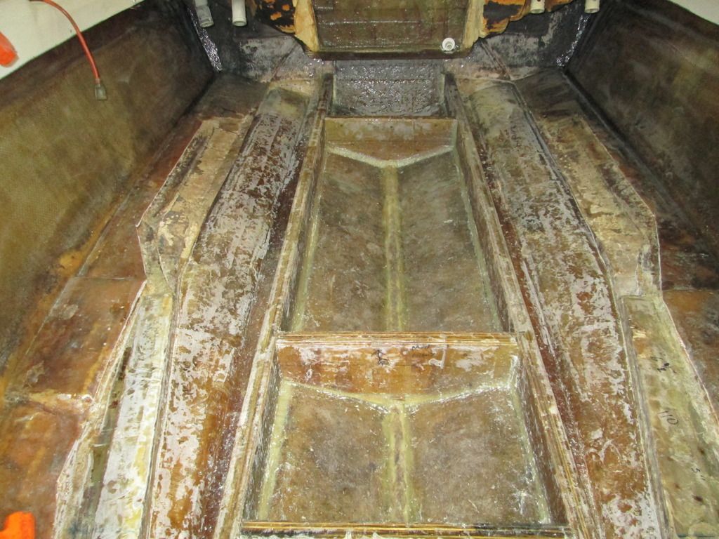

New stringers built, fiberglassed, sanded, and dry fit. Ready to start building bulkheads and getting everything bedded with PB and tabbed in with csm and 1708.
