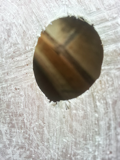

Today's drill-while-you-grill session was brief but necessary. I started to bevel the area surrounding the hole left after removing the below waterline thru-hull the PO put in so he could pump out the porta-potty into the lake (jerk).
Only ground on the outside so far. Took it from the original 3/8 or 7/16 down to about 1/8 or 3/16 thick. Will bevel it similarly on the inside as well.
Focus up that close is not good.
I'll lay a layer or two of 17 oz biax on each side followed by several layers of 4 oz cloth, each layer being a slightly larger circle than the previous. The last will be slightly smaller than the ground area, so I can fair over the top when done. Inside, there will be a larger layer or two of 17 oz over the final round patch, to additionally bond it to the hull inside.
