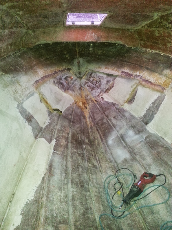

We laid the tank on some cardboard in the approximate place where it will end up to create some room in the forward half of the cabin:
That tank sure collected a lot of dust since being painted.
Then began to finish ripping out the remaining scraps of headliner and the small bulkhead walls that used to be the V-berth:
Spent some time with the shop-vac hoovering up chunks of leftover foam and bits of wood and glass. I'd hose it out, but with all of the rear portion glassed in, I don't want to flood the bow anymore.
Today I'll get out there and rip out the couple of pieces of tabbing that didn't just rip loose with the wood. They really weren't very structural at all.
Once all the grinding is done and it's all cleaned up, the fun part starts again -- laying out the design of stringers and bulkheads and ledgers. It will be different than original. I'll adopt a design used on later Victoria models, featuring a galley floor that is dropped another 4-6" from the sole, allowing you to stand upright all the way forward to the skylight hatch. The dropped area will only be between the center two stringers, and the remaining sole will be at original height under the galley cabinets and settee.
