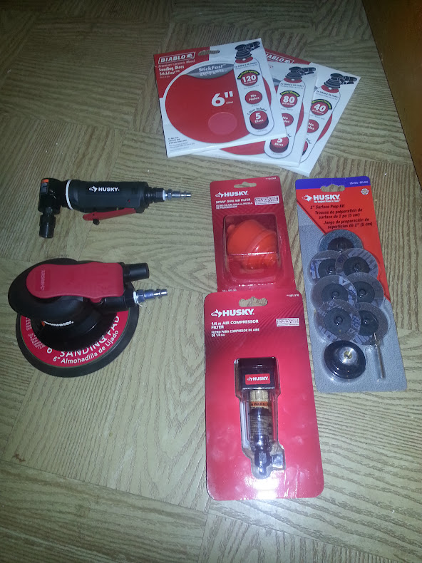

Santa brought toys that will come in handy come spring.
Maybe even before spring :) I can weld lamp brackets on the trailer as long as it's not snowy and wet. Or sub-zero. I will be so glad to reserve my old manual helmet to visitor use.
