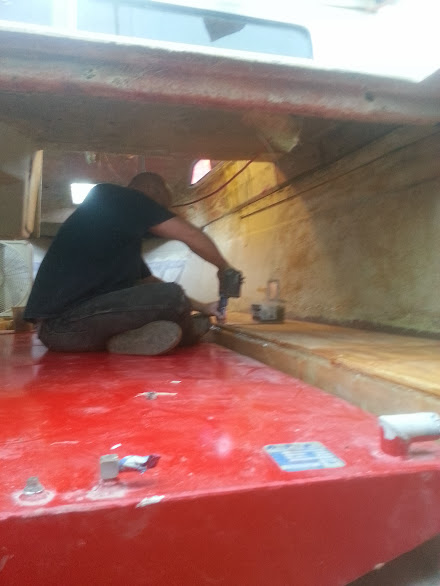

It was only 2 PM, so we looked at each other and asked "So, what's next?" :)
I had the PL, and the screws, so we spent a little while wiping everything down with acetone, and got busy laying down the sole along the edges of the bilge and the fuel tank.
1/4" bead of PL, and screws every 8" around the perimeter, with each screw dipped in PL before driving it home.
And then after that, there was still a little daylight left, so I broke out a roller and a pan of BilgeKote, and gave the sump another coat.
There was still some paint left in the tray, so gwpjr grabbed it and gave the inside of the transom a quick coat.
All in all, a productive day. :)
