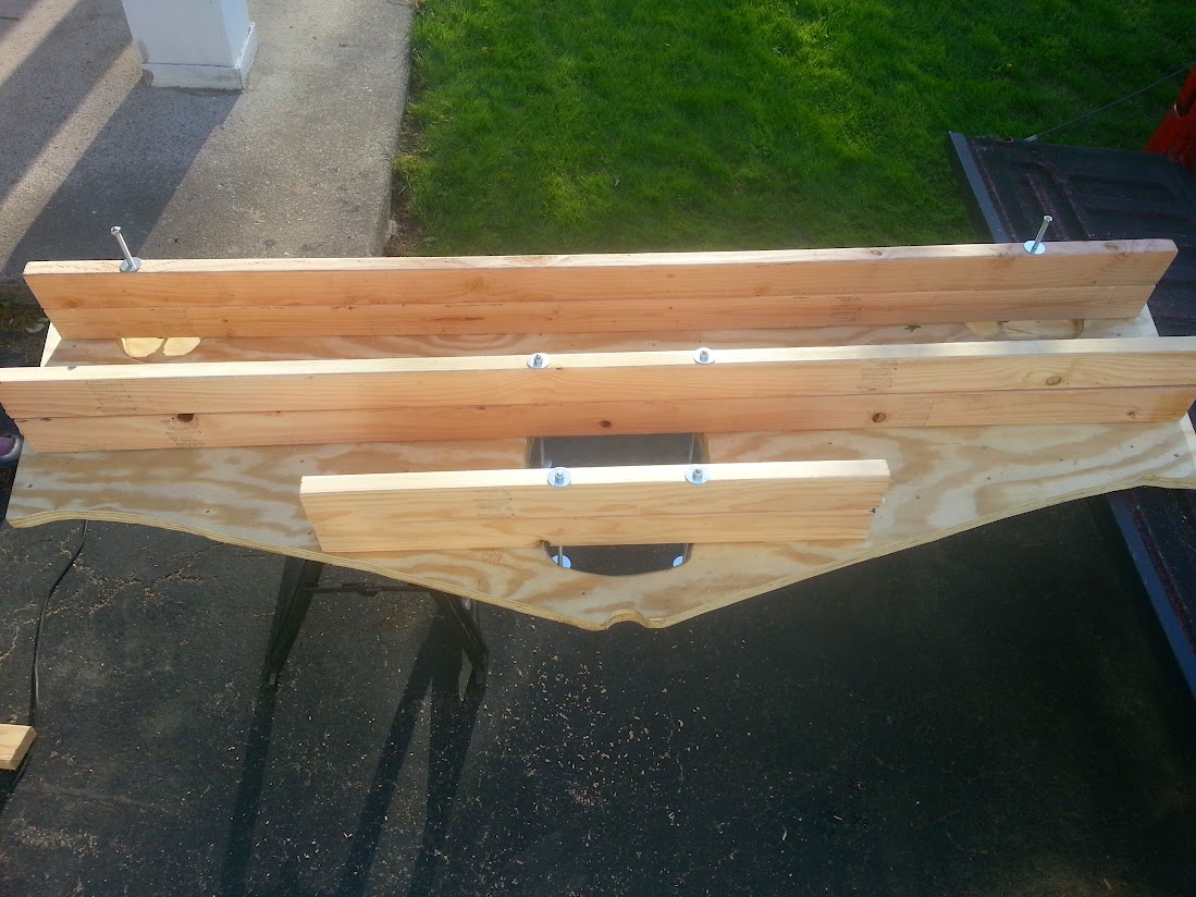

Today I finished making the clamps:
Then I wet-out the edges and fore side of the transom. I'll probably wet-out the aft side tomorrow night, and maybe the inside of the skin if I'm ambitious. No pic of the transom. It looks the same, only shiny :)
