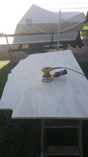

Today I sanded and cut the other head wall while gwpjr painted the cockpit with topside paint. I put the new tires and rims on the trailer. gwpjr also oiled a lot of the teak parts we'd removed earlier. Man do they look nice.
