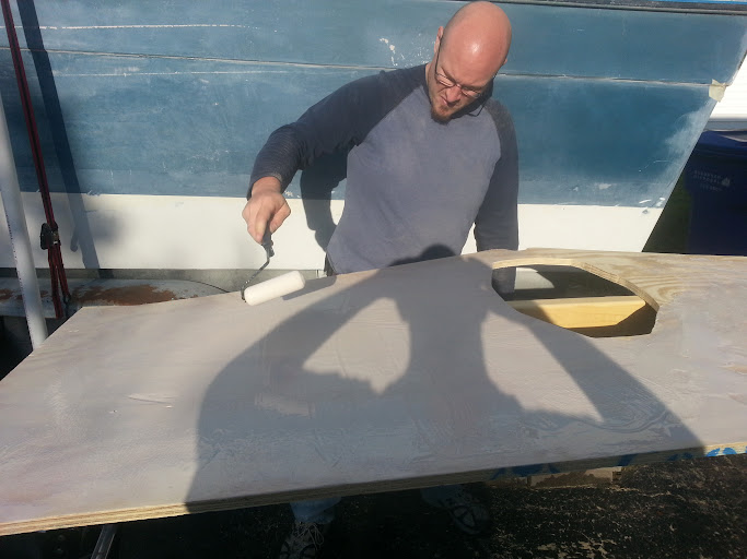

Test fit
Glued
And screwed
Beveled the top edge with the table saw, and sanded all edges smooth
And before ya know it, it's a transom!
Kept gwpjr and I out of trouble for the day. Was going to rig up the clamping bars and all-thread tomorrow, but my hot water heater sprung a leak tonight, and that'll be the first priority tomorrow. Well, and Mother's day too, but unfortunately in that order, if Her Admiral-ness expects to shower. :)

So what made you choose the titebond over PL? and are you removing the screws when its dry?
GWPSR
Jul 25, 2012
758
Re: 1981 Bayliner Victoria 2750 - Restore or Bust
I'll be using PL between the wood and hull, applied to both with a notched trowel, horizontal rows on one, and vertical on the other.
The TiteBond is great between two relatively flat and even surfaces, and goes down really easily with a roller. Yes, the screws are temporary, and will come out before I seal the edges and apply one layer of cloth over the inside surface of the transom. I could have removed the screws today, as it fully cures in 24 hours, but with Mothers' Day, there was no boat time today.
My US Composites order arrives tomorrow. Need to wait for the weather to get out of the 50's before I break out the epoxy.
Probably dabble with making up the clamping bars (2x4's, all-thread, fender washers and nuts) after work a couple of nights.
Looks like Friday is the first reasonable day, with a high of 74 forecast. Maybe use a heat gun to pre-heat the edges of the plywood then to get some penetration of resin into the endgrain.
Either way, it's going to be much more substantial and longer lasting than what Bayliner put in there originally. The original wasn't even sealed. Just painted. And the doubled portion was just in the center.
