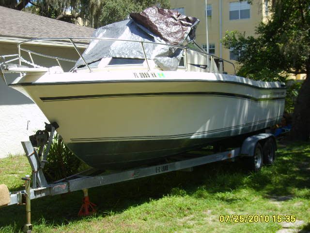

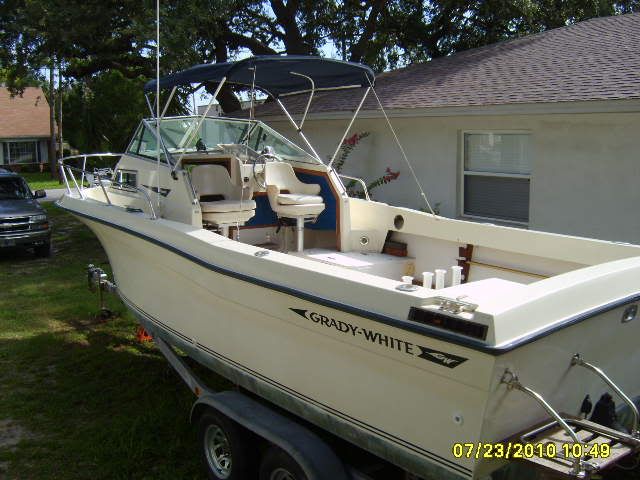

Here's a few pics of my 90% completed boat project.

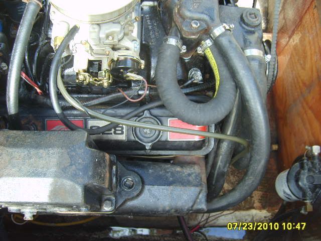

Here's a pic of my fuel line. Just two bend and that's it!

Thanks for the extra pic Ron. I have the Merc 260, so I have shift linkage on the fuel line side of the carb to deal with. No worries though...I bought some copper line this evening, took it slow making my bends, and it came out fine. Now I just have to figure out a throttle cable bracket!

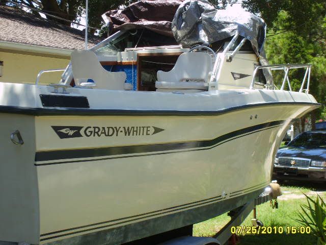

My son put the stripes back on today. "STILL NO BOAT NAME! The old boat name was "Triple Option" and don't know what that meant to the former owner.
